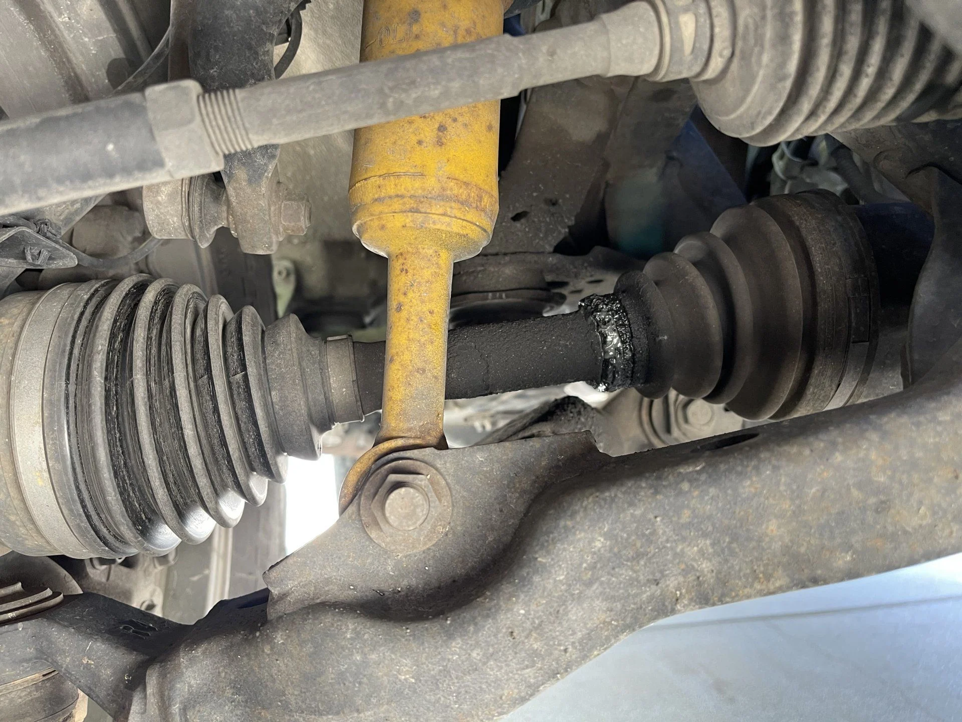

2008 4Runner 6-cyl w/ 150k miles. Original CV axles, I believe.
Inner CV boots are seeping grease, as you can see. I believe my mechanic has added grease and tightened the gasket in the past.
OK to leave as is if there are no other problems? Thoughts?

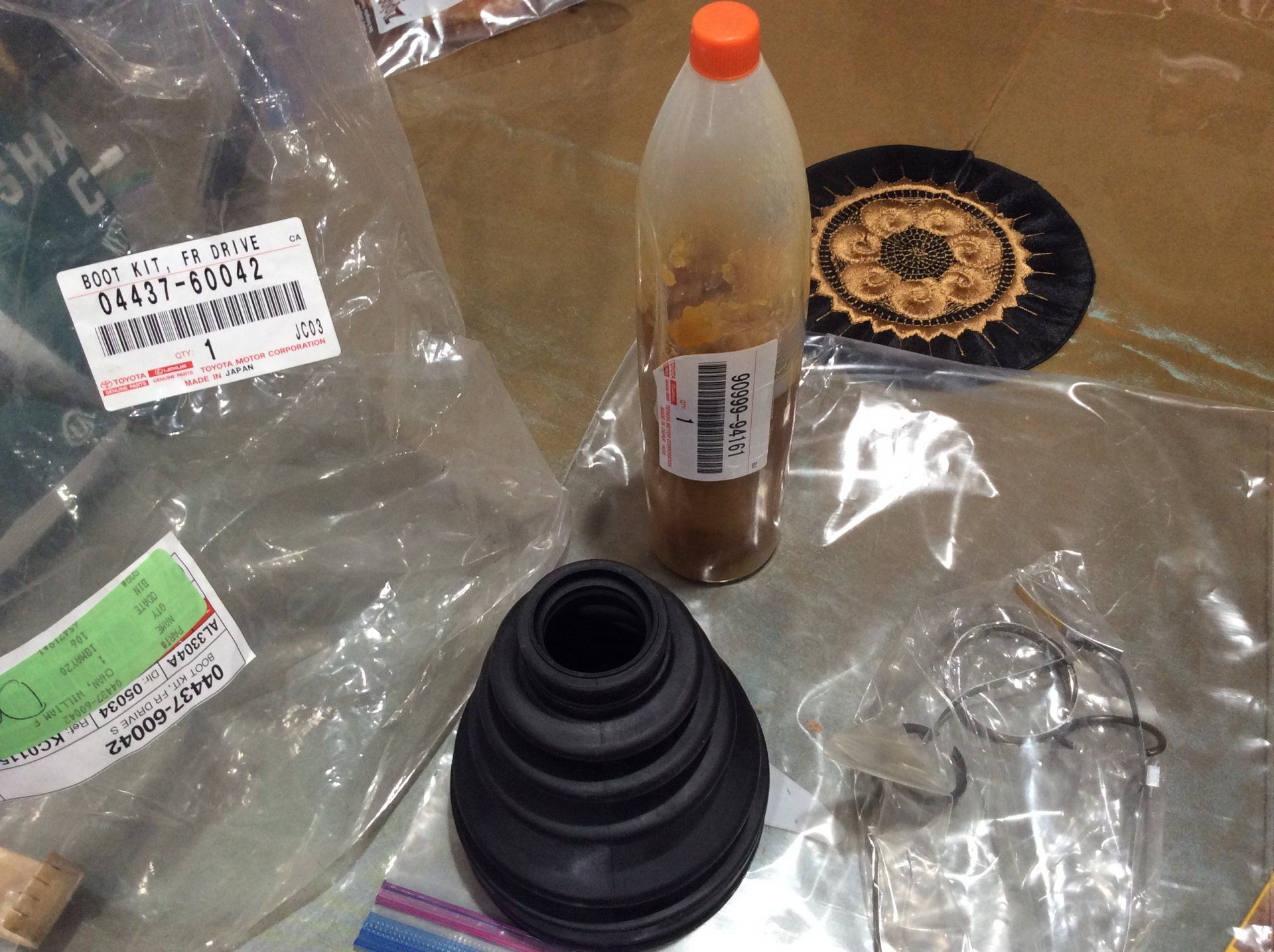

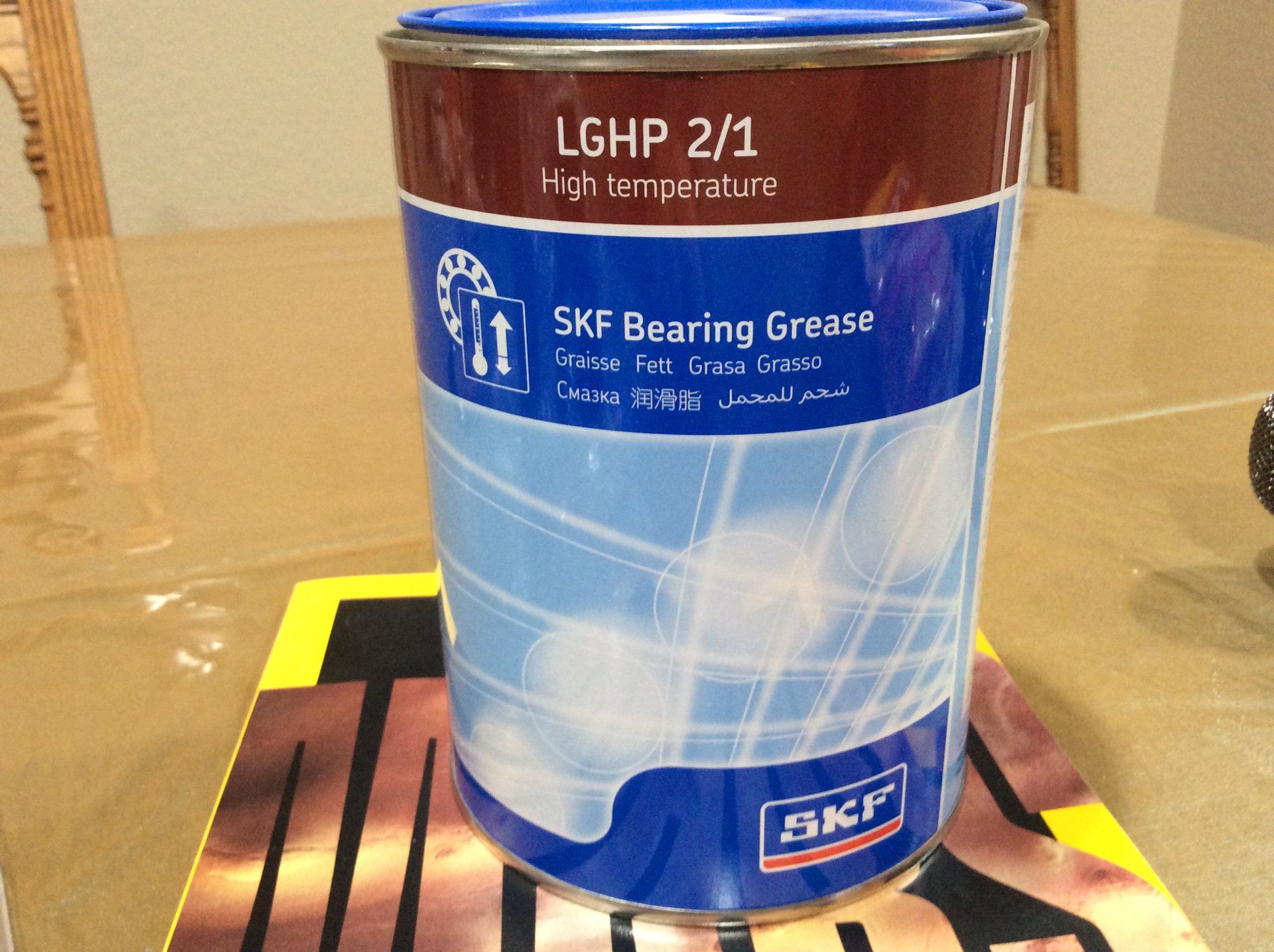

Your mechanic probably put molybdenum based grease in your inner boots. Those joints are tripod roller style joints. They call for a polyurea based grease. That’s what comes in the Toyota boot kit.
Thanks @fjc-man
Any suggestion about what to do now? I think I can read the part number on the bottle in the picture you posted.
Should I buy and add that to the boot?
Thanks @fjc-man

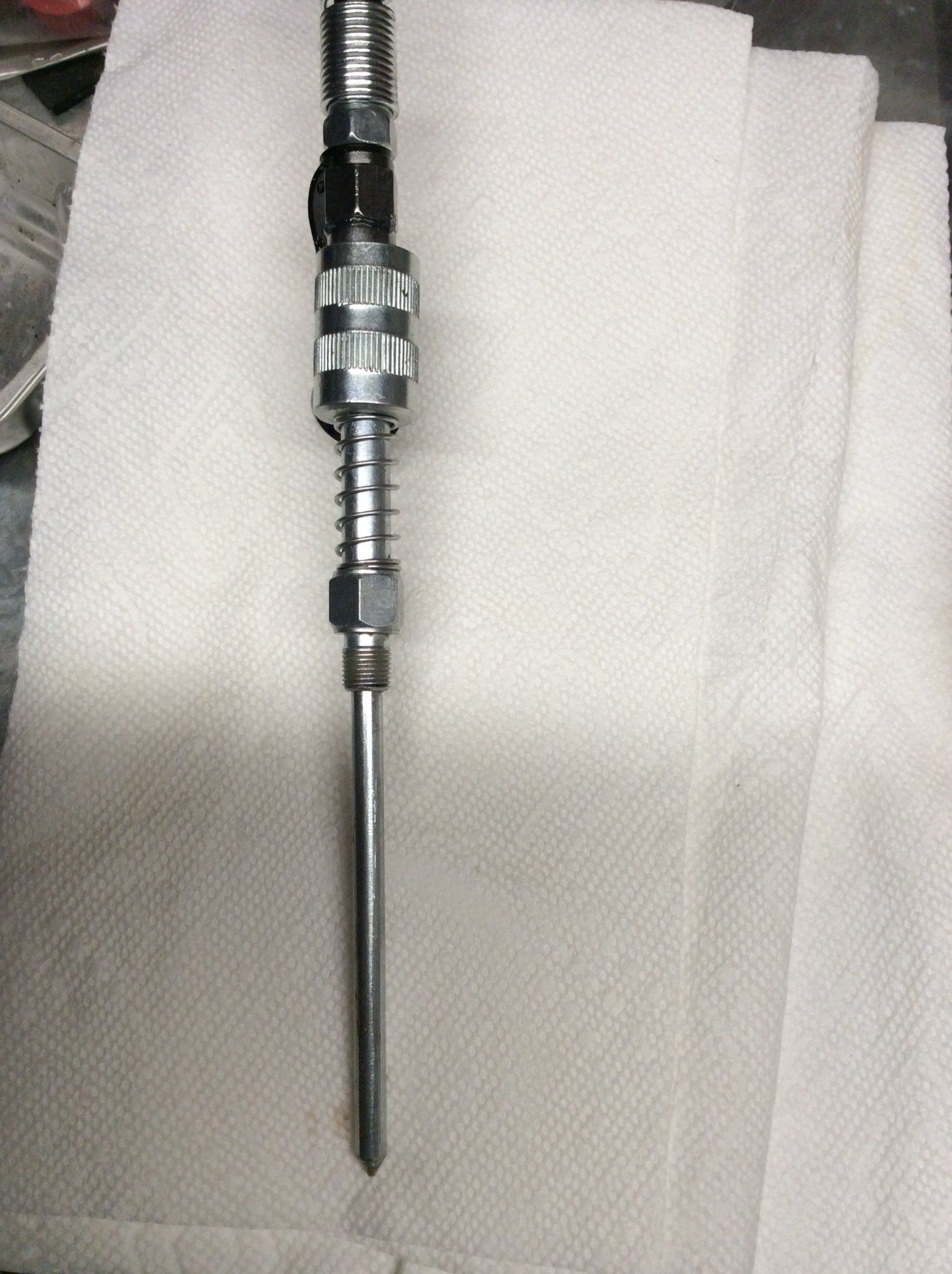

If you’re doing the work, remove the old clamp and add an additional 6oz of grease with the pictured needle style tip to each boot/joint. Then reclamp with a worm drive style hose clamp. If you decide to replace the axles as complete units, you might have your mechanic tackle this job as it’s way more involved. To respond to the part # for the Toyota supplied grease, the only way you can get it from them is with the whole boot kit. That’s why I posted the picture of the grease equivalent I came up with. Soo, if you’re thinking of pulling the axles to replace the boots you might as well just install new axles while you’re in that deep.
