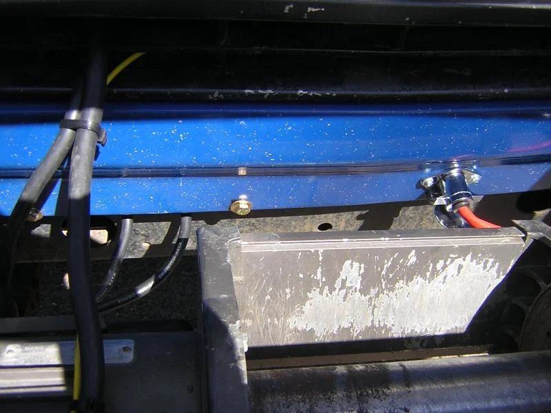

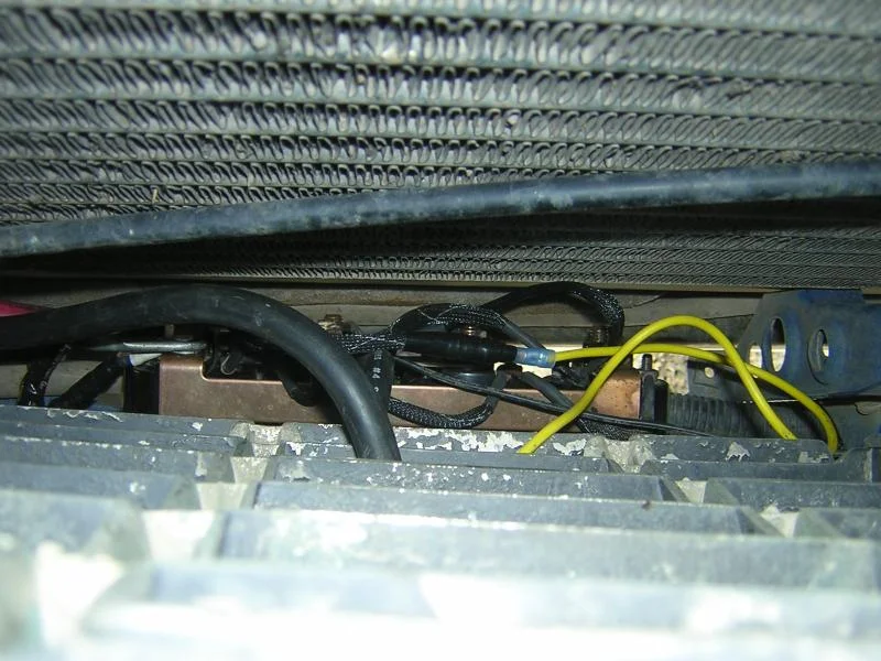

I'm full blown into modifying my XD9000i to fit my older ARB 60 bumper. I cut the solenoid pack housing off, rolled the winch on its back and bolted it up that way. I relocated my solenoids behind the valance. My plan was to use the original warn connector mounted through the hole in the valance that was originally intended for the crank start option. It was going great until I pulled a little too hard on the connector wires and pulled the white one out! After pricing replacement parts from warn I decided to make my own.
So, new plan. I went out and bought a trailer connector set-up. I plan to wire the solenoids myself. Because the XD9000i runs a 5 terminal connector, my question is.. Can I run it using just the standard 3 wire set-up? I heard that the 4th and 5th wires (red and brown) are just a ground that is run through the controller. What if I just loop the ground terminal from each solenoid to the housing on motor?

Finally got it all wired up. I tested it this morning and it seems to work fine. Thanks for all the help.
Here's one more with the extesion cord mod. Also, the trailer plug setup fits perfect with no mods in the crank start hole in the valance.
