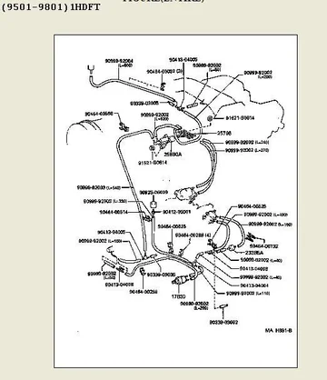

info for 1HD-FT vacuum routing
Will this help
interesting enough I think I may have to check my own pump now, Im sure there is a mod from the PO....
Me too. Am looking for a diagram to put the vacuum connections right. My engine is not idling up on turning the steering or starting the AC. Actually, it is slowing down when it heats up.
I think the vacuum hoses are not connected properly.
Hey man , the port on the top of the compensator is to boost and on an auto the port under the compensator is to vacuum . When converted to manual transmission get rid of the lower vac port, not needed
I have converted an auto 1hdft to manual trans and have worked through all this crap and have deleted heaps of unused lines and poop
Looking for info on routing of vacuum lines for non-egr 1HD-FTE
I’ve removed the egr pipe and lost all boost is this because the valve is still on there or do I need to re route some vacuum lines if so a diagram anywhere cheers
