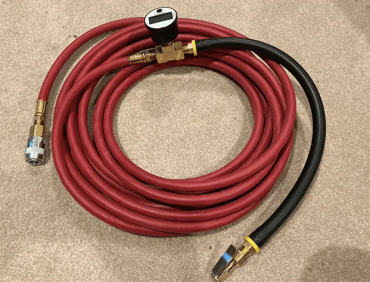

I couldn't stand the goofy fittings, and cheap plastic tubing/hose, on my Smittybilt compressor, so I converted mine to something more familiar:
It was my understanding at the time, that you needed to use a free flowing chuck with this type of compressor, so I ended up using something like this:
I suspect that you could use a "T" fitting to add a pressure gauge (on either end), but at the time it didn't seem worth the effort to me.
A quickly cobbled together example, from parts that I had laying around.
