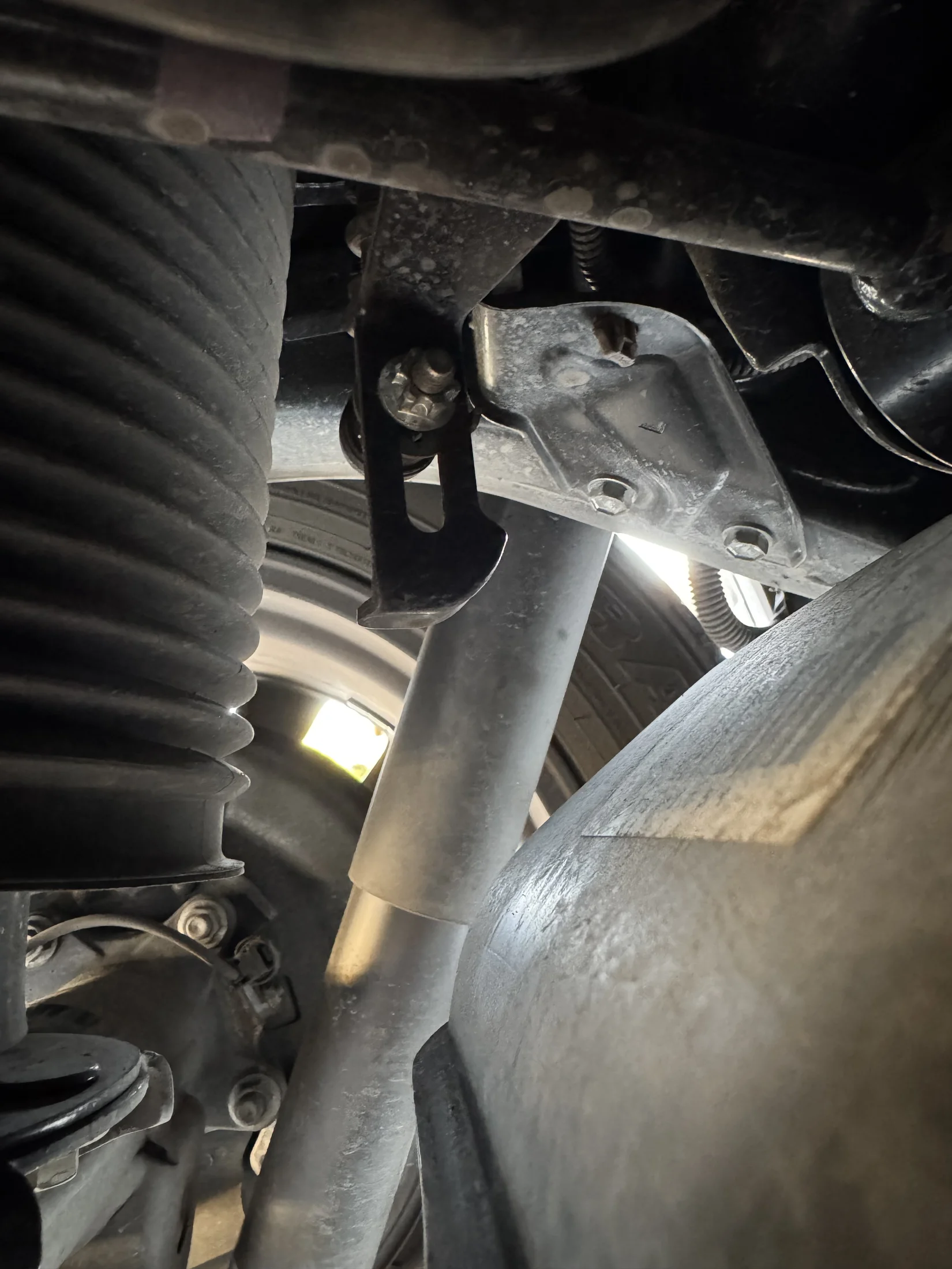

Bumping this oldie up. Trying to fix passenger side lean. During inspection I found the driver side slide adjuster set all the way up, and the passenger side half way down. Anyone else see this before? The threaded rods are set equally. Appears to have been this way from the factory.
View attachment 4124770View attachment 4124771
Those height sensors are always different like that, my past 2023 Tu dra was the same but they will not correct side to side lean because the air pressure in the bags is shared.
