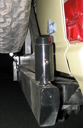

Worth a shot. My first attempt was with a greasable pivot I got from a welding shop. Seemed pretty stout but it had a tiny amount of play with the weight of the tire on it. No big deal, but it proved too much vibration for the cam-over latch which snapped after a couple months.
This is pic of the pivot, sold by Rockstomper, I switched to - $45.00, way over built for my little 31" spare but I won't have to fix it again.
https://forum.ih8mud.com/attachment.php?attachmentid=3338
Be cautious of the one from Rockstomper. I have no previous experience myself but have heard stories of them flying off down the freeway. :whoops: What happens is that the base metal fractures throught the heat affected zone. Basically a material selection issue.

I finally nudged a pole with it (smashed the rear window in the process- pretty strong nudge) and still, it held on. A week later and a few thousand crappy roads.... and the whole thing just fell off. One minute we were driving along.... the next.... we pulled into a gas station and a taxi driver pulled in behind us to tell us that the tire was in the road!! Fortunately, it was only a few miles back and we had some room on the roofrack to put it up there.
Anyhow- the point of all this? The carrier spindle was only barely welded on. There is almost no evidence that it was ever there on the bumper. I'll post a pic tomorrow. Amazing. The little bit of weld held that spindle on for nearly two years.
I disagree. I'm sure it'll hold the weight. I can ride my daughter's bike without it collapsing. Dividing my weight across both wheels = 100lbs on the front, add to that the fact that the fork will act as a lever from the point of the front axle, multiplying the stress on the joint. How much does your spare weigh? If it fails, I bet it fails where you weld it to the back plate.
