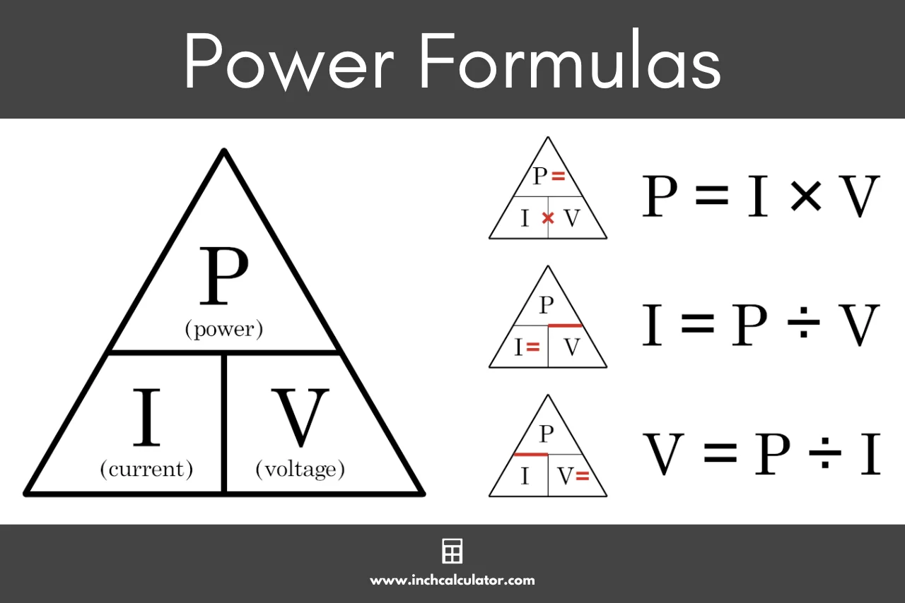

That's very odd that it doesn't give power requirements, e.g.: wattage or amps, but only AC and DC voltage requirements.
Knowing your voltage doesn't help, one HAS to know at least 2 of the requirements to figure out the third.
I even did a quick search for the fridges power requirements and no luck. You may want to email them about that.
V = voltage
I = Amps
P = Watts
V = voltage
I = Amps
P = Watts

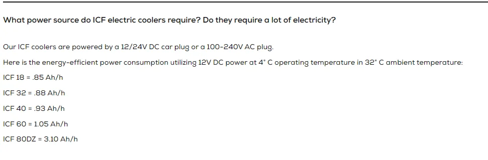

Here's the screenshot of the power consumption on Igloo website. It's odd how they listed the unit as Ah/h. I honestly have never seen it like that before. Cancelling out the hour (h). This unit run about 0.93 A on 12 V so thats slightly less than 12W of power. Typical 120V out let in the car is about 100-150w so you're good.

Thanks all for the replies, after some internet searching and youtube watching I decided on this unit. supposedly runs ac at 60 watts peak which should be good for the 100 watt rated plug... but then again there might be some ohms type formula I should know.
Generally with refrigerators, there will be a very short and little power spike when they start up but then settle into their rated power usage.
The power spike is only to get the relays, motor and pump all started up.
