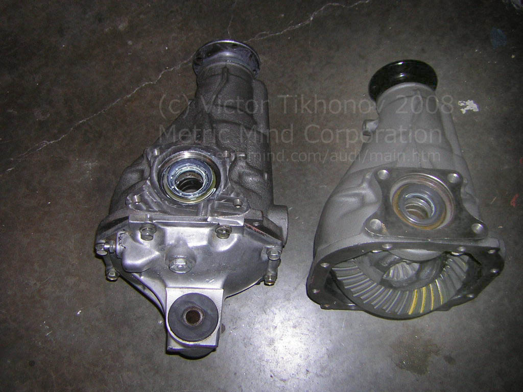

^For all we know it could mean the torsion snubber built into the front cover like in the lower left of this picture.
Okay guys.... Sorry I don't have pictures, if one of you were to look at the IFS diff, drivers side axel you will notice a mount, that is what I am referring to, it is very similar to the mount found on the front of the diff. Mr. Toyda calls it a Stopper, don't argue that's what the Toyota system calls it. I will try and get some photos so I can more accurately describe what I am talking about.

FWIW the industry term is either a pinion snubber or more commonly called a differential carrier bushing.

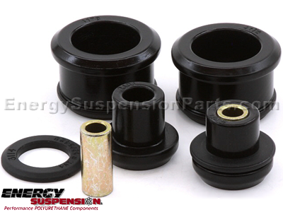

Energy Suspension has them and is where I got that pic of the snubber at.
Yep, first place I checked, however they are no longer available, that being said if I had a pert number I can have them check
Old stock #'s 52283-35010, same # was used all the way up through 1995 and it's how I found the other part above.
Cool, thanks!
Okay perhaps I am a blind idiot, I can't for the life of me fine the part I'm am looking for anywhere on Energy Suspension's site. I tried the part number you gave me, I tried a search and still nothing, where are you finding these and can you post a link to the exact ones that they say will work for an 86 4Runner front IFS differential.
