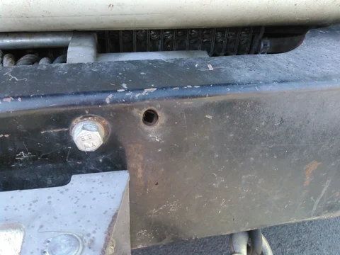

Just another idea. This is what I have done to both winches on my 80. Mostly to keep me from smashing the lever off the winch, but will slow people down.
Its a stock lever chopped off with a random 1/4" drive socket welded to it. Now you need the 'key' and to release tension to free spool the rope.
Bandit, can you please post more pics of that?
