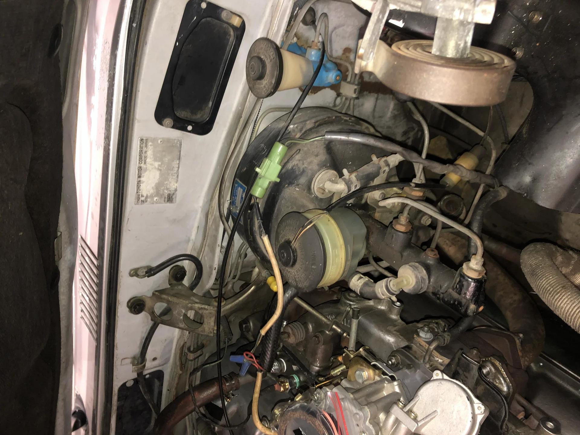

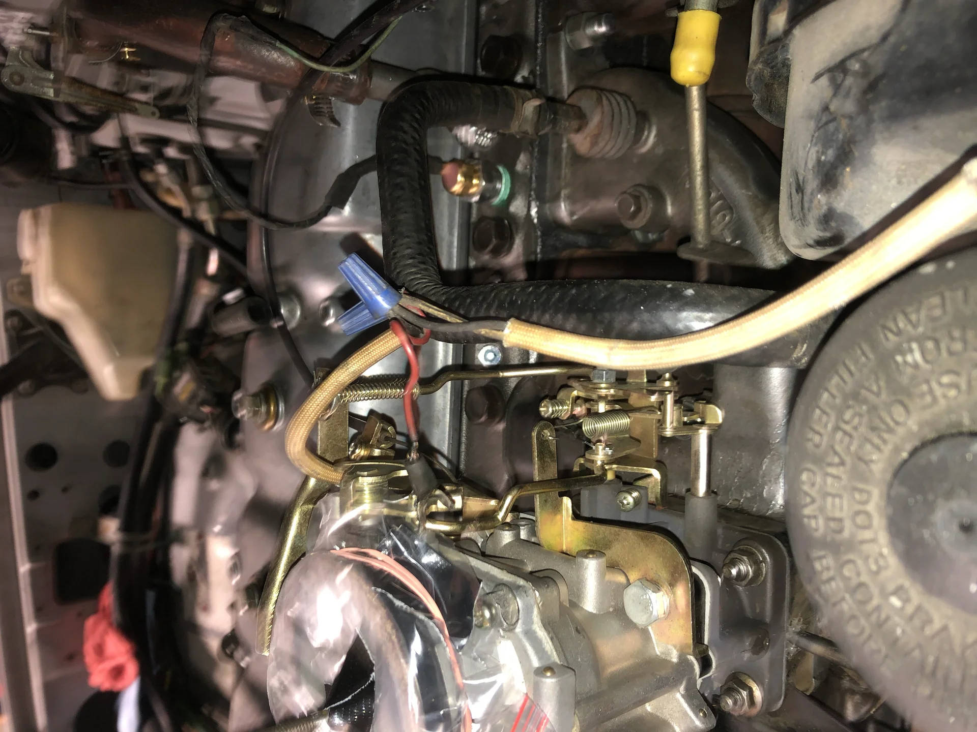

Hey guys.. Hijacking this thread
Asking generally how you hook an aftermarket carb with fuel cut and vaccuum siwtch choke etc with a DESMOGGED rig. That ide stop solenoid clipped into that plug, SO assuming its already grounded? I know I still need my throttle plate, but not sure beyond that what needs to go on.... this is one of the chinese aftermarket carbs.
Attatching photos..

Also one of the wires is broken on the lower clip side of the fuel cut solenoid...Im holding up the part that broke off in my hand upon examination. This part broke off somehwere higher up beyond the tape. any recommendations on repairing this? could explain my uncontrollable revving when I turned on AC.
PS Im installing a rebuilt engine right now...
ICS will be a single wire on the Aftermarket carb. Hook that to the Green wire that went to the old two-wire ICS (should get 12V on the green wire with key on/engine off).
Yes, one-wire ICS is grounded through the carb body.
The Vacuum switch for decleration won't function now because it uses switched ground to function (through the emissions computer), with the two-wire ICS, which is no longer there.
Sell the switch if it's working; they're NLA.
