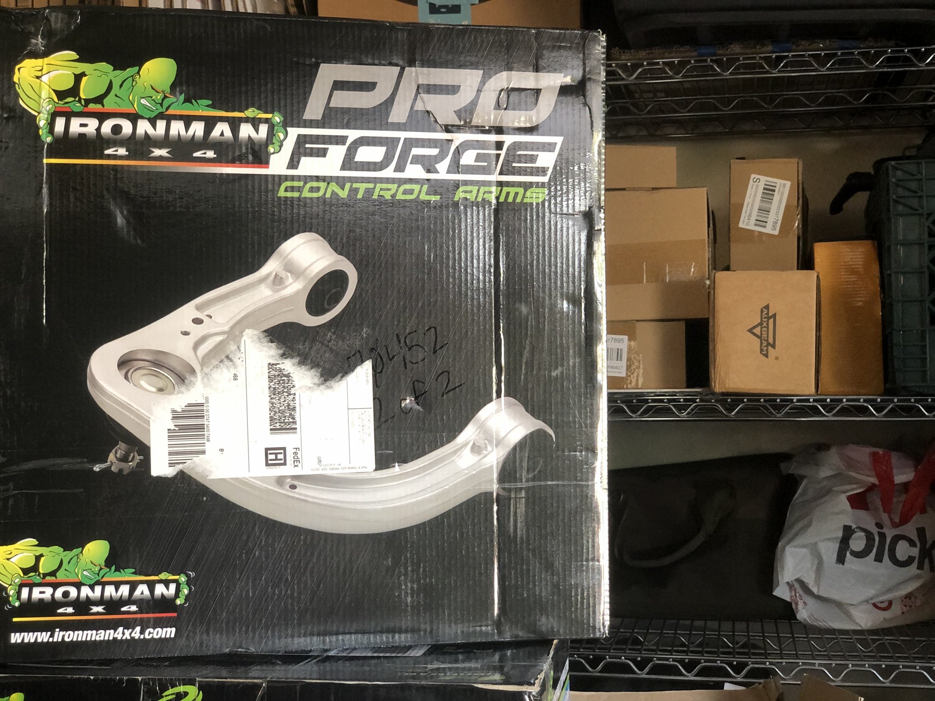

Well....
There goes this month's Costco shopping budget for your family! :p
Truth be told… they hooked me up fter hearing me whine in the last video.
Here’s what cut down the ice cream budget slightly.
Lexus doesn’t hook up idiot youtubers… but I’ll still make a video and a bunch of s***ty jokes cause I love y’all.
