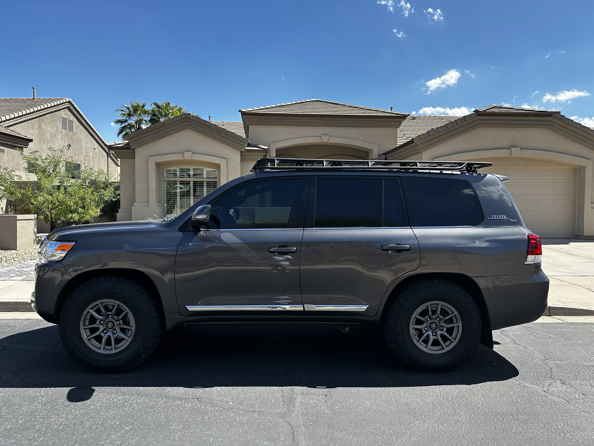

Titanium on a 2021 MGM with 285/75/17 stock suspension.
That looks really good as is. Before your lift comes, how much rubbing/cutting did you have to do?
Tons of rub before some massaging and molding.
You need to Remove front flaps, hammer back bracket behind front flap, heat the front liners and push them back. The front right is kissing the KDSS bar but nothing serious.
I would say unless you’re willing to do some molding, light cutting, and reshaping of the bracket then stick with 285/70/17 or similar. I think it’s common knowledge now that a lift doesn’t buy you any more tire clearance for the body, so testing it before a lift is the best way.
