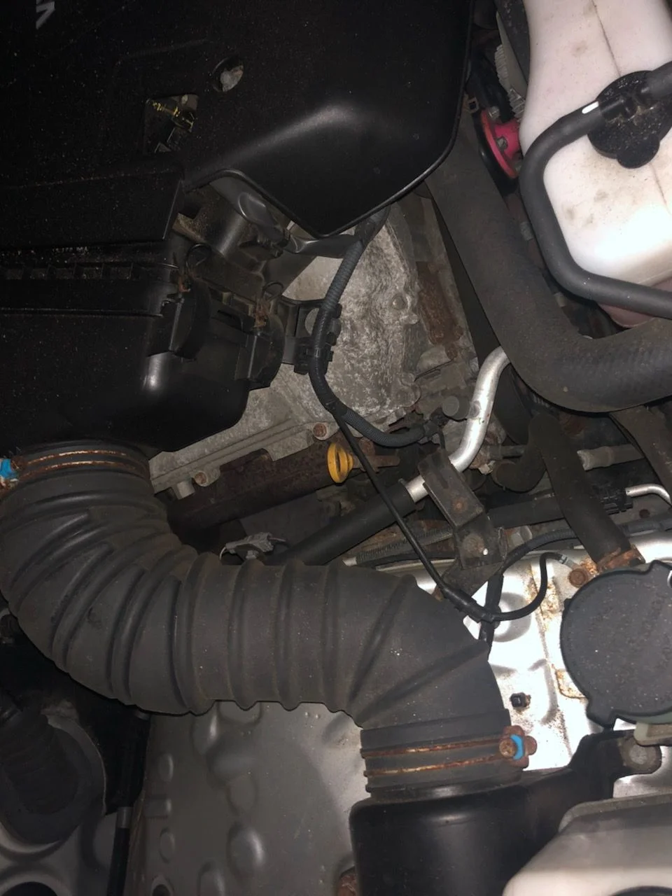

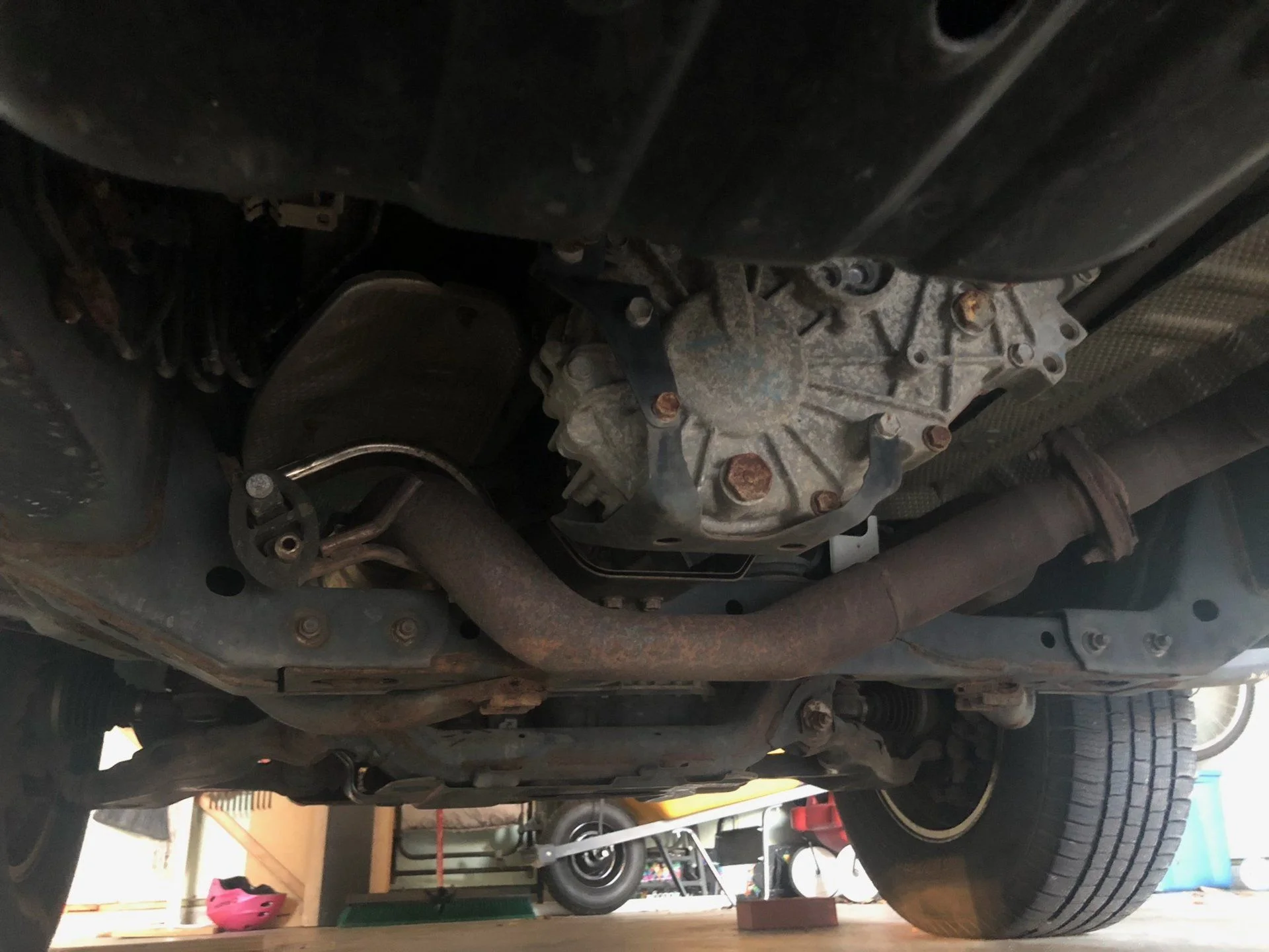

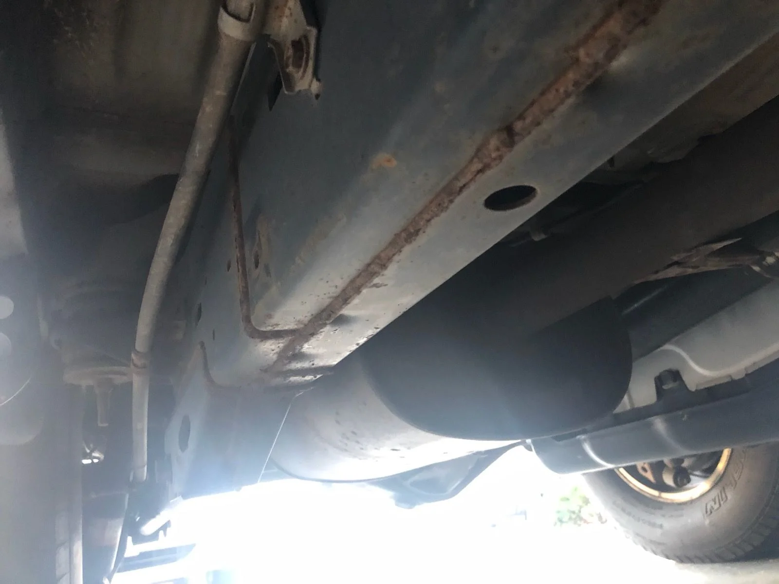

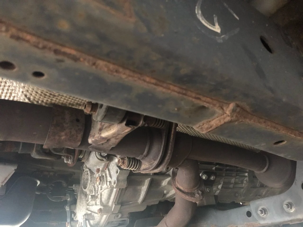

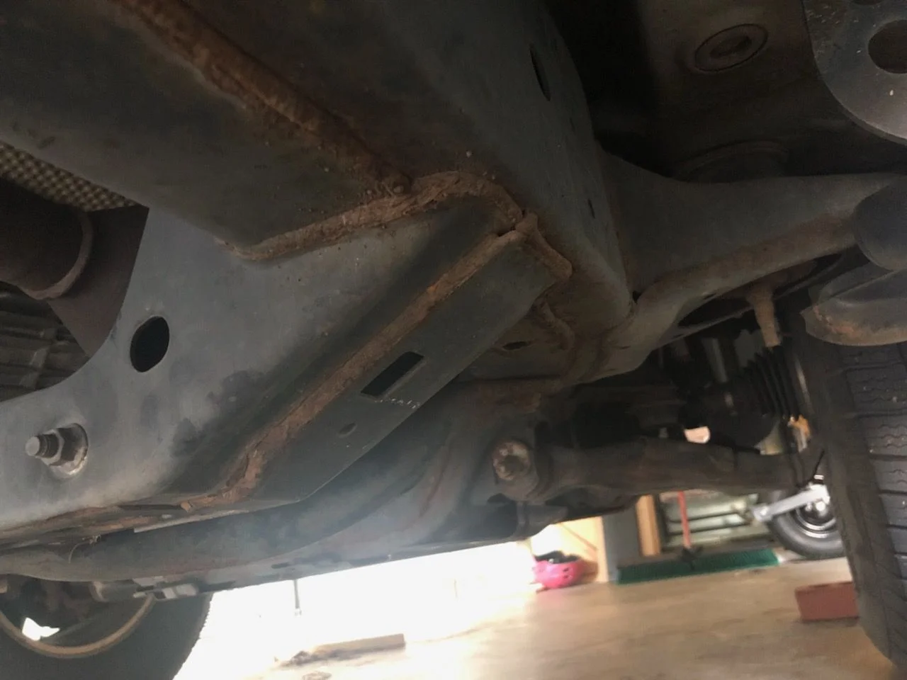

I asked for photos of the undercarriage and he sent me several, which I am adding here. I would like to hear from owners of FJ's and any advice you can give. I'm a little scared of the rust in these pictures but not sure if it's typical or if I should pass on this one. I have a 40yo, '78 FJ40 that, unfortunately, has a lot of rust, and I have a '97 40th Anniversary Edt. FZJ80 that doesn't look as rusty underneath as this 2008 FJ, so that is one of the reasons I'm asking the community about this. Also, any other tips or things I should be looking out for on this beast when/if I go to look at it. Thanks in advance for any input you may have.

That's more rust than mine has, and it's a 2007 with 200,000 miles on it.

Doesn't look terrible to me. I live in Northern Virginia and that is just something you have to deal with every few years with some good PM. Anything from this coast is gonna have rust on the welds and some other issues here and there. Just get under that sucker, brush off the rust you can and seal it up with your choice of product... When I was looking I saw way worse... but I was only looking at 10+ years. My 11 was a find. I found it in NY but it was mostly garaged. There is some rust, but nothing like that. It is also 3 years newer so take that into consideration. Most of the FJs I looked at on lots looked exactly like that underneath. Find one from a different area maybe? I got lucky. Keep looking if you're really worried about it. I waited until I was satisfied. You could aways offer a lower price and explain you will soon need a new exhaust and will need the underneath tidied up. There is definitely worse, but definitely better too.... Sorry I don't have a better pice of advice!
Frame and body rust is one thing, but when hose clamps are rusted, your work is cut out for you.
that's what I was thinking. My 97 40th Anniversary Ed. 80 doesn't have rust like this 10yo FJC. I was thinking, if the hose clamps on the air intake hose are rusted, that high up in the engine bay, how much salt has this poor beast been subjected to?

That is not bad for a 2008 from Ohio, but it will need some R&R to address. 6 speeds are relatively rare, and you will probably have to choose vehicles from the rust belt with such issues, or those from the Southwest that have been offroaded hard. Your decision will depend on what use you envisage and for how long. What does the interior look like and what is the service history? Any sign of flood damage? Any oil leaks from the front of the engine? Pay attention to the clutch for proper operation on a test drive for the bearing/bellhousing issue, and the gearbox synchros. Confirm that the rear differential at least has been serviced, preferably with synthetic oil.
