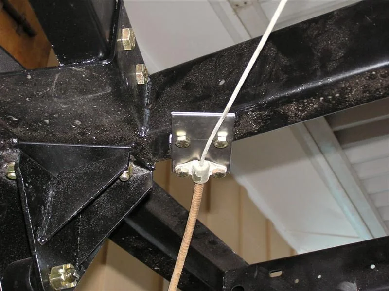

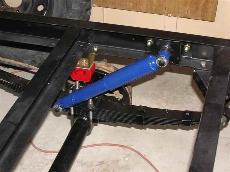

Hi John,
Here are some photos of how the trailer brakes on my M416 are set up. You can look at my rebuild of the trailer here, Two Week Wonder.
Here are the photos.
This is how the brake handle connects to the brake cable.
attachment.php
attachment.php
I had to make these extensions for the cable housings because I did a spring-over and the cable housings would not have been long enough to reach the brakes.

In this photo you can see the cable housing running behind the shock and where it attaches to the brake assembly.
attachment.php
I hope that this helps you.
