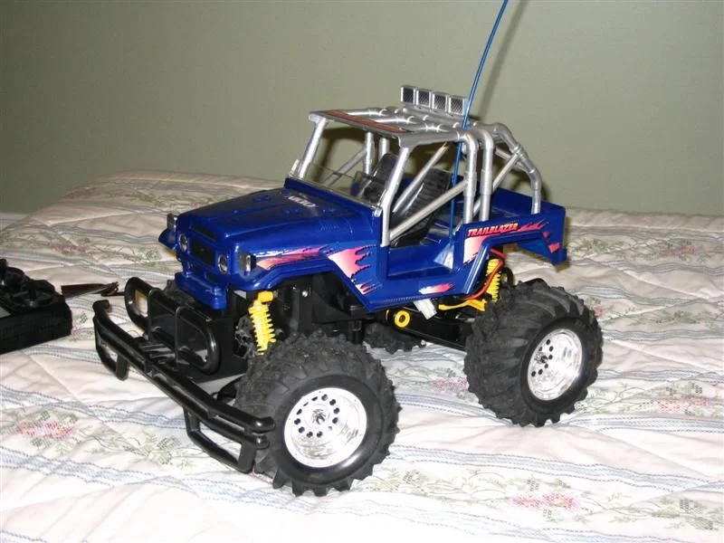

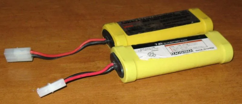

these are my cheapie RC's how do i know if i can use a lipo
both of these will kill my 7.2 volt nicd 1200mAH and 1500mAH in about 10 mins.
not very fun cruisin around the yard for only 10 mins :doh:

I don't know how to tell with those, but i would venture to guess it's a no. One if not both of this will happen: 1. burn up you motor or esc because it can't handle the juice or 2. ruin or explode the lipo battery by overdischarging or overheating it.
If you have a wall charger that came with them head to a hobby shop and pick up a cheap venom 1500 mAh pack that will be compatible with the charger (take the charger w you) If you wanna put a little money in it and get a little longer run time you can get 3600 mAh batteries with a better charger and get better (not black and white difference but noticable) run times
You cant change the speedo in those as they are toy (throw away once broken) cars. But if you get into hobby grade cars your batt and charger will spill over into the new car
2c batt would be compatitble with the car but prob wont fit in batt bay. 3c lipo at 11.1v would fry the speedo in a few mins.

Unfortunatly the battery you have linked is a Nimh so you would need a new charger for that,would be very long run times though.
Lipos you can get them hardcased to fit the cars you have,BUT they are 7.4 volts 2S packs instead of 7.2 volts in the Nicd or Nimh.You can get a small add on alarm for the lipo that plugs into the balance led on the battery,these batteries have 2 sets of wires running out of them now,this will monitor it and when the voltage gets low it beeps/buzzes and warns you to stop running.
Gens ace 4000mah 2S1P 7.4V 25C hard case Lipo battery ROAR Racing Approved Batteries
You can find these at the local Rc shops,RCpitstop in Langley,SNhobbies in New West or GH hobbies here in Richmond,I think they run between $40-$45each,you will need a new charger if you decide to use lipos or Nimh.
A real popular site for very cheap lipos,chargers and general hobby stuff is www.Hobbycity.comI believe the site above,HobbyPartz is the US location of Hobbycity,shipping from them I recall was under $10 at one time to Canada.
