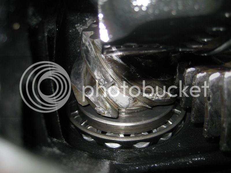

OK, I got the 3rd out this afternoon. Jerry, I can take more/better photos of the ring gear later if you want, but the short story is, it's the pinion that went this time. Photo looking down into the 3rd:
About 1/3 of the teeth are gone. Here are the biggest pieces that were sitting in the bottom of the housing:
The ring gear is OK, except where it has been grooved/notched by trying to mesh with the broken pinion.

When I blew the stock gears the first time, I was hopping the rear end with it locked, trying get up Wipeout Hill on the Seven Mile Rim trail in Moab. But here is the deal this time - I loaned my truck to some friends when their (cheby) truck broke down and they needed transportation, so I don't know what happened. What I suspect is, their 18-year-old son who drove it back to their farm probably tried to go wheeling on their farm, and didn't know what he was doing and probably tried to use the skinny pedal to get out of whatever situation he was in. When it broke bad enough to have to be put on a trailer, he was on the highway. He's not admitting anything, so who knows? It could have been weakened already and it's time just came when they had the truck. I'm not bent out of shape over it in any event, just one of those things.
