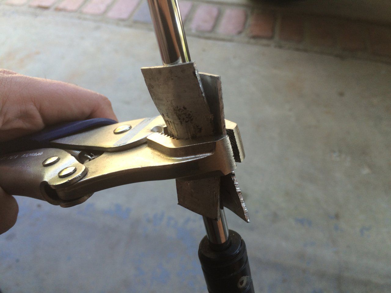

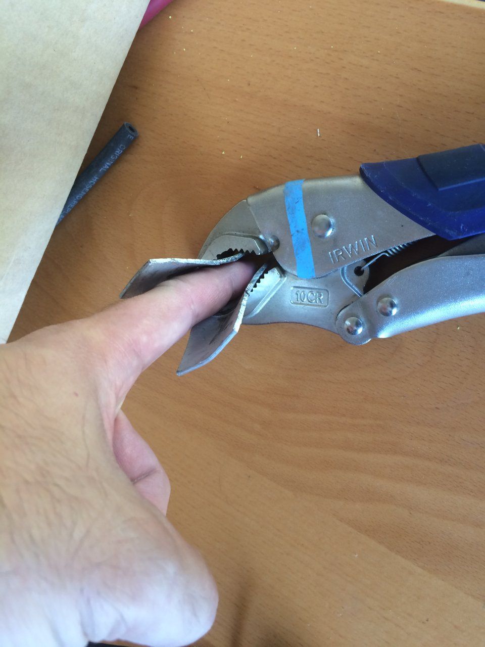

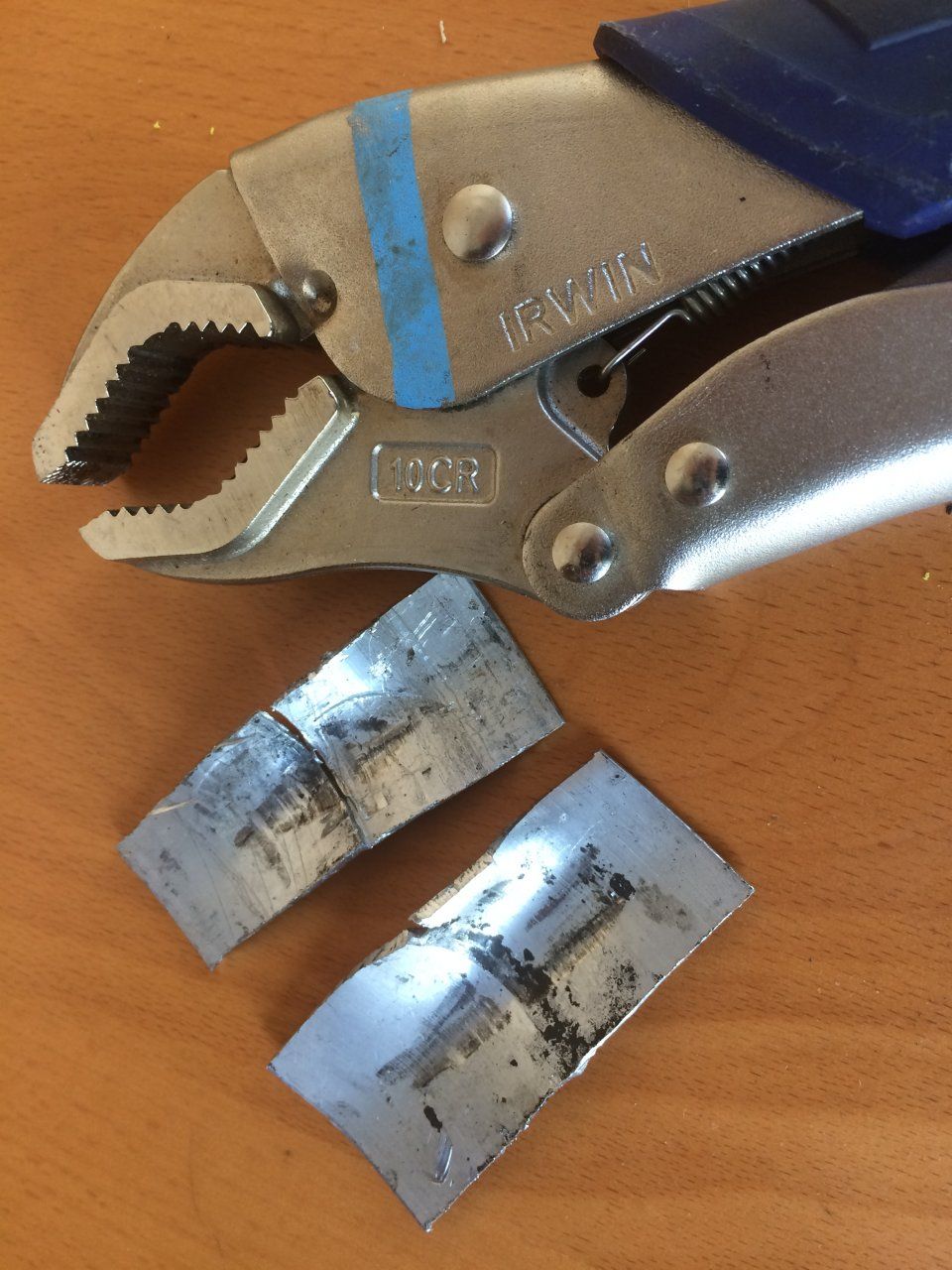

You guys are all seriously overthinking a really simple problem. I have the same two little strips of aluminum I've used I can't tell you how many times.
Stick in your shaft of choice

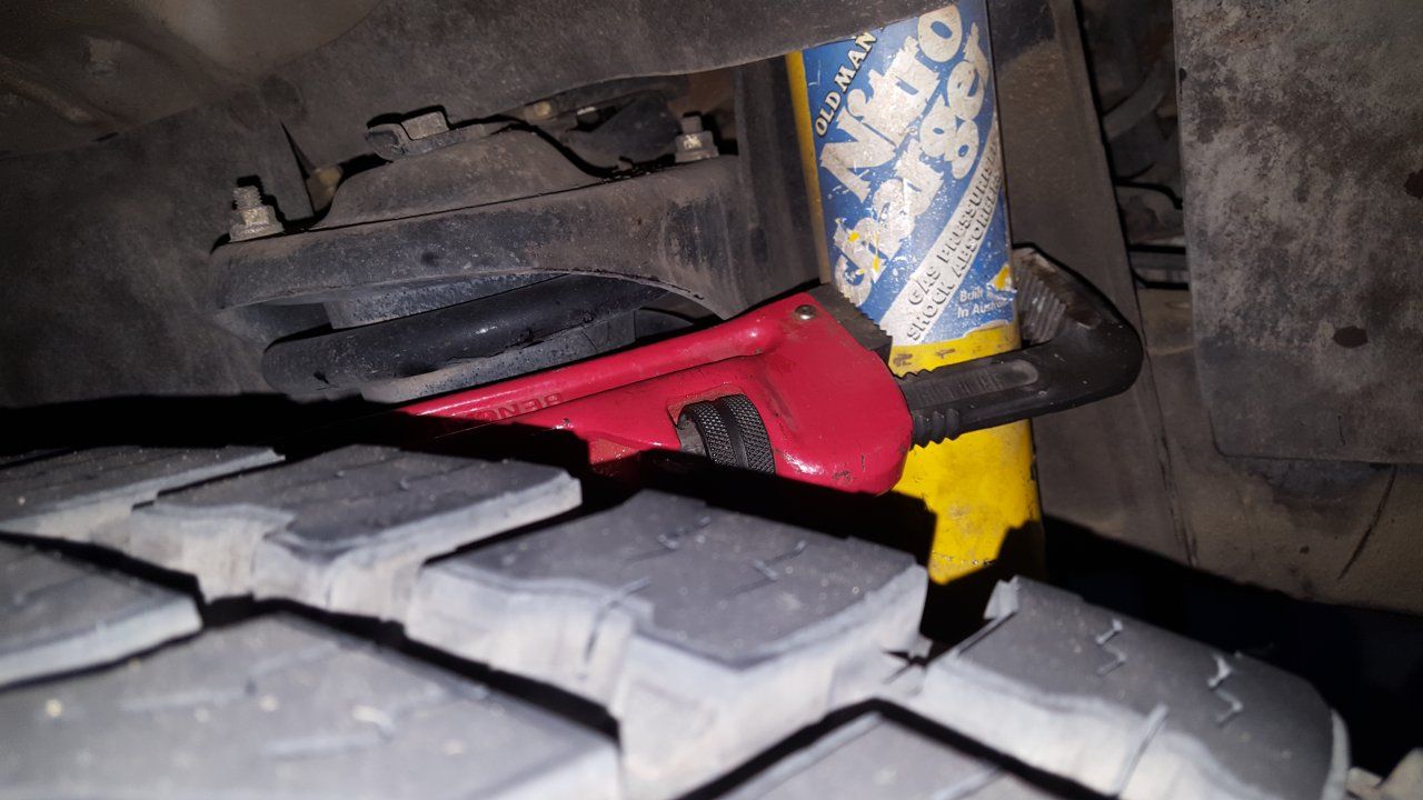

For the next guy coming down the road with no impact wrench or extra set of hands...pipe wrench Yo! Wedge it between the tire and spring.
