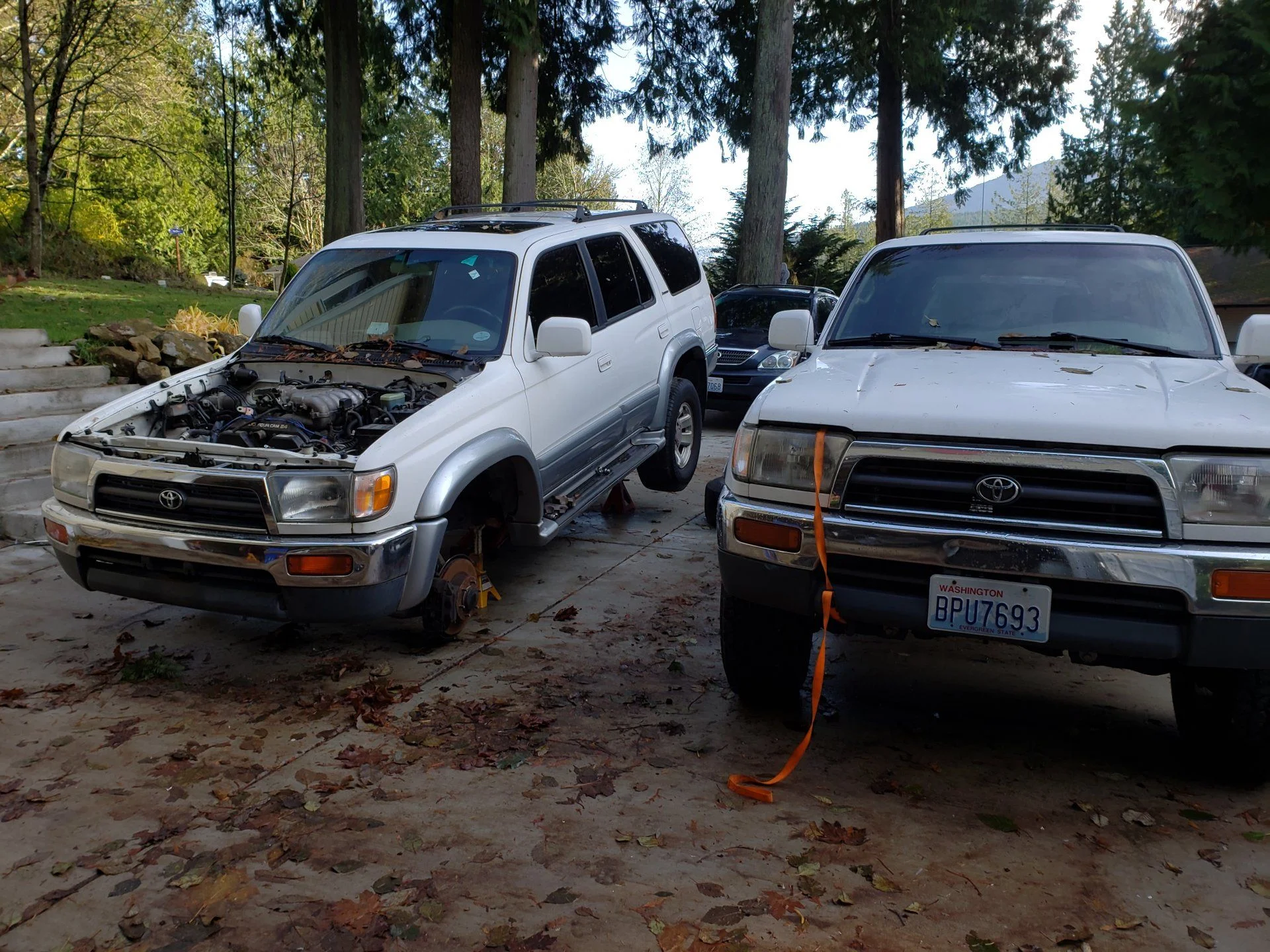

Back in September our 1997 manual SR5 got Tboned by a 16 year old making a Uturn on a main 5 lane arterial. Whoops.
While we waited for the state to determine what to do with the title status a 97 Limited with a bad motor came on the market.
So... now we have a 1997 Limited SR5....

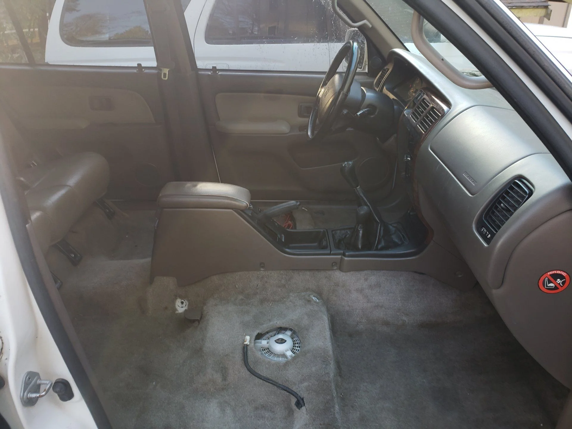

Limited body and axles (aftermarket suspension added)
Swapped all of the glass (the Limited tint was purple, swapping glass was easier)
Limited wiring harness (notes below) - I DID NOT swap harnesses as the T4R group said I would have to.

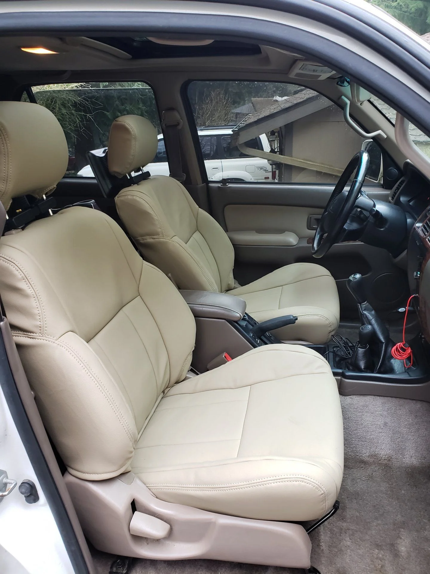

SR5 manual front seats recovered in Lseat leather and KBD seat heaters

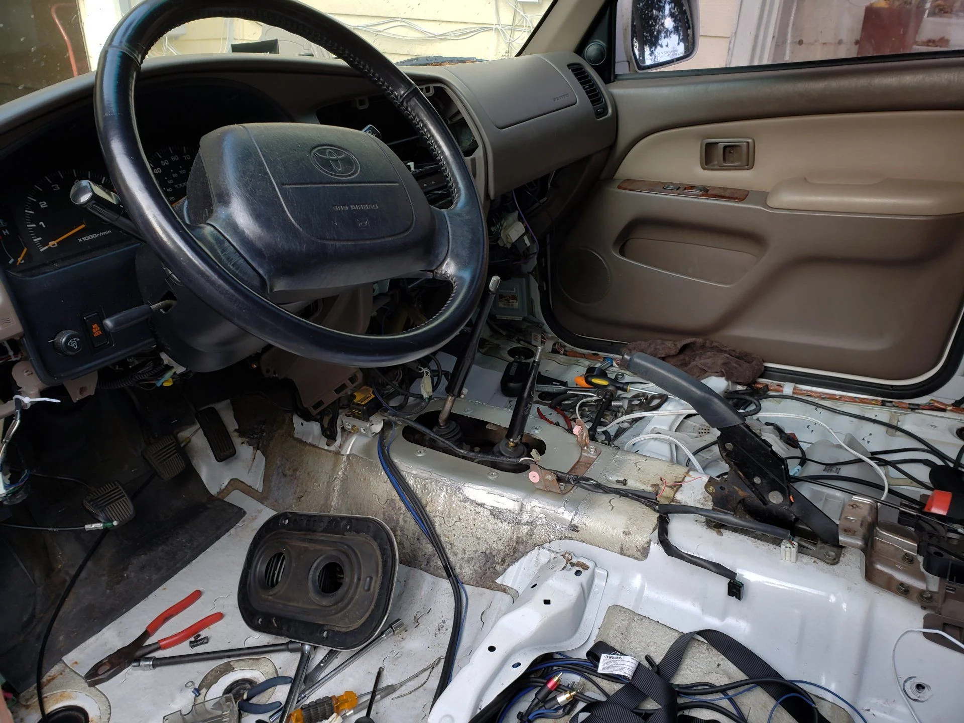

Engine, manual transmission, and J-shift transfercase swapped in.
Manual transmission engine harness tied into the Limited body harness.

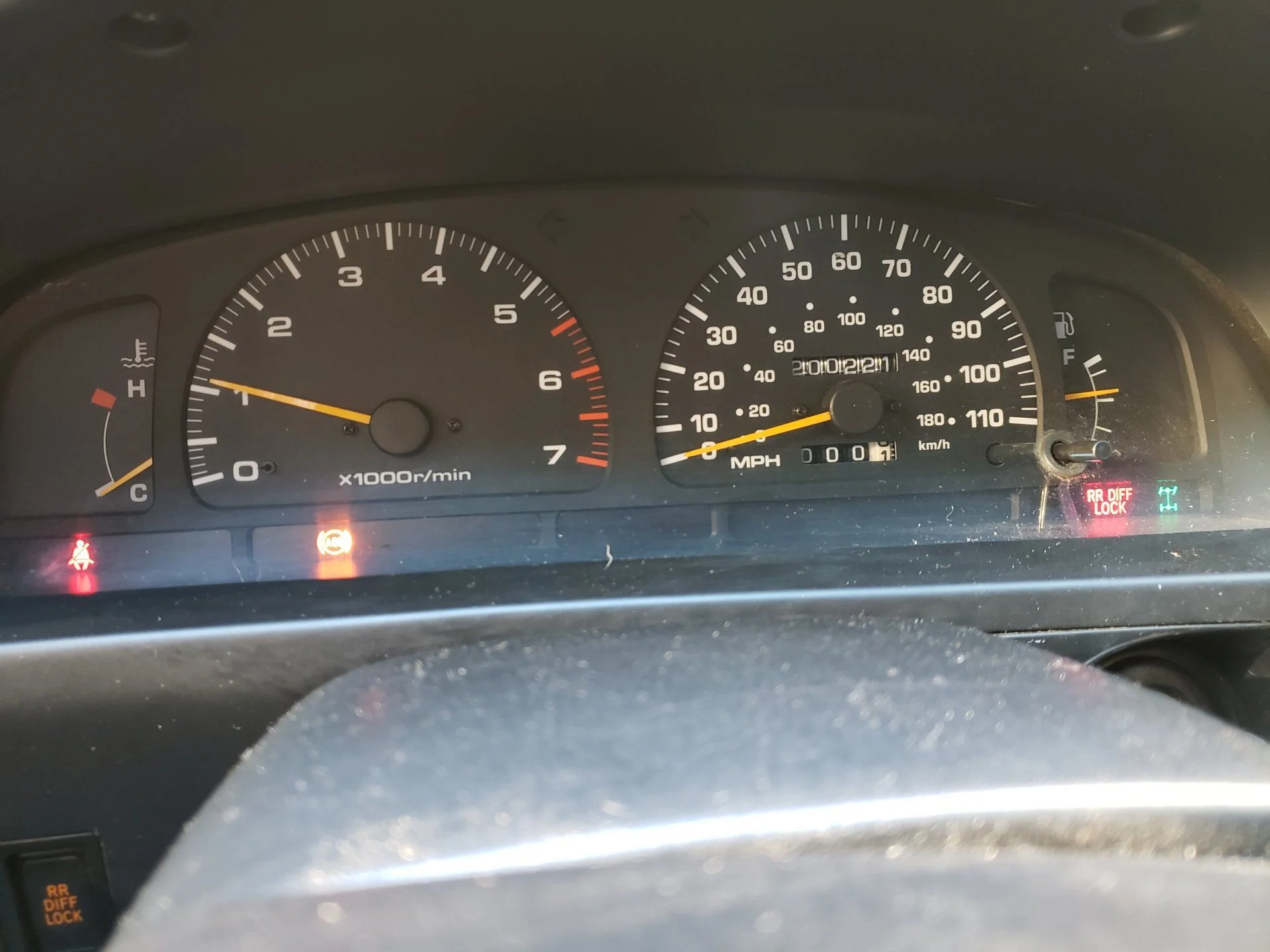

Still has the 4WD ecu to control the front ADD, using the J shift transfercase to trigger it.
4wd and rear diff lock all working.
While the motor was out I regasketed it down to the head gasket and replaced the flywheel, clutch, and PP.
It's the way Toyota should have made these Limiteds....
