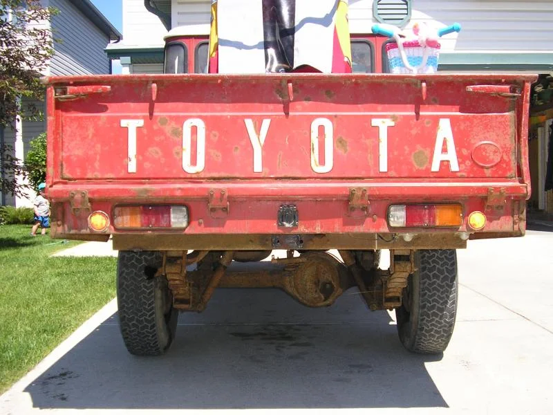

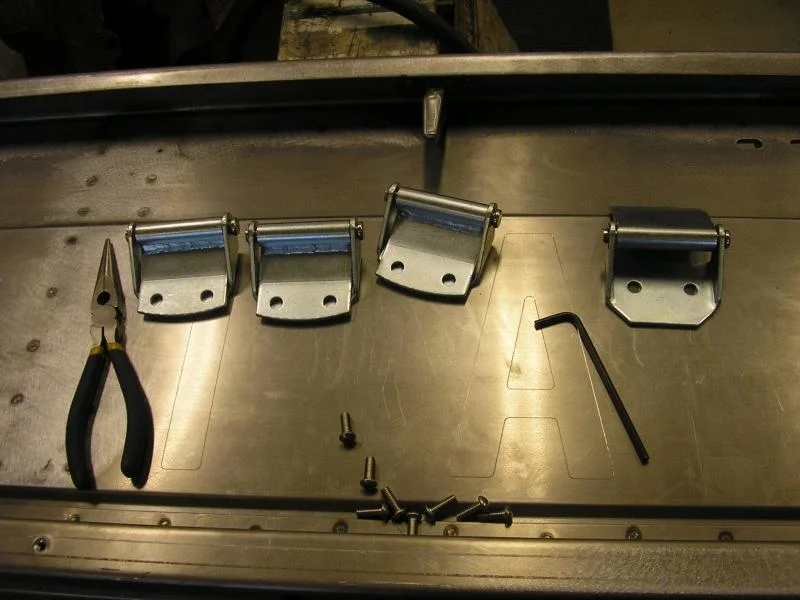

nice hinges ,
but something is curious on my Cruiser
I have no holes for bolts in the middle of the frame :hhmm:
may be I have the first lightweight "green Cruiser" Toyota ever build to save gas :D

Nice to see you posting again Peter. I was wondering where you got to.
Your rear valence must have been altered (holes filled) at some point??? Perhaps not the original tailgate :meh: It looks to me that you have some different model year parts there. Hard to tell in the photo but the tail lights look old style and too close to the ends of the panel compared to mine (1978). My lights are longer.
I made sure to set aside four hinges for you if you want them :grinpimp:.

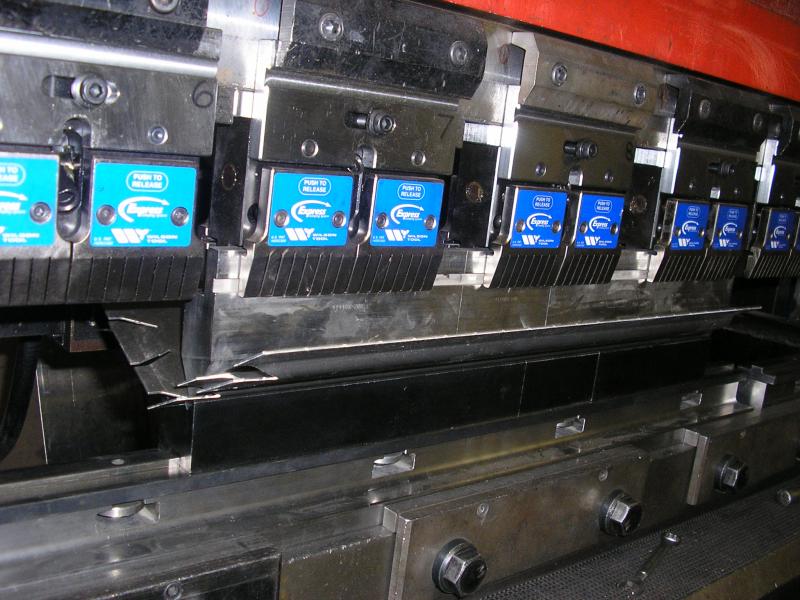

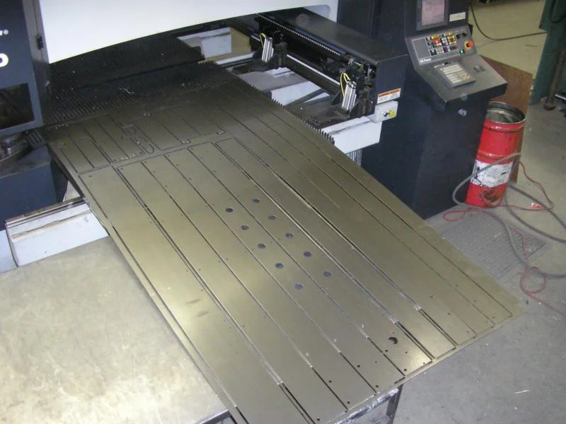

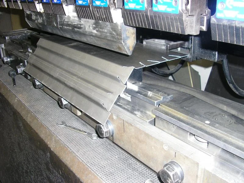

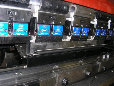

Here are some shots for you.
Programming is anywhere from 20 min to 2 hours for the flat layout depending on the complexity of the part. Then programming the brake is maybe another 30 min to an hour. There are over 40 pcs per bed (not counting lefts and rights). So thats anywhere from 34 to 120 hours... say average the two at 77 hours of programming and you haven't even made anything yet! You still have to setup the machine with the proper tooling and actually punch and bend something....
I'm not charging enough :frown:

I envy you Sir. :). I seriously am going to put this thing up on my "Have-to-get-and-learn" list. :). I know its serious stuff but the results are worth years of learning involved. :). Way to go. Please take some VDOs of the machine in work as well.
