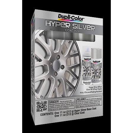

The best match i can find from before…researched a lot to be used for my turbo twist wheels…almost impossible to perfectly match…though it came out fine.
