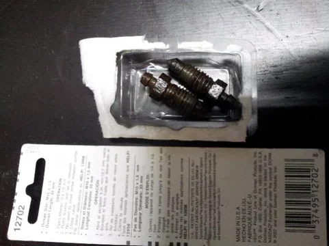

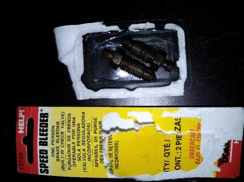

Turns out I replace eldo calipers bleeder here is a pic of my old ones and the one that replace.
Model for reference

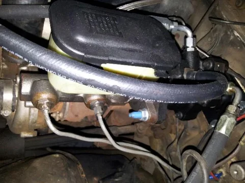

And my actual HB setup with eldo MC 1" Bore
