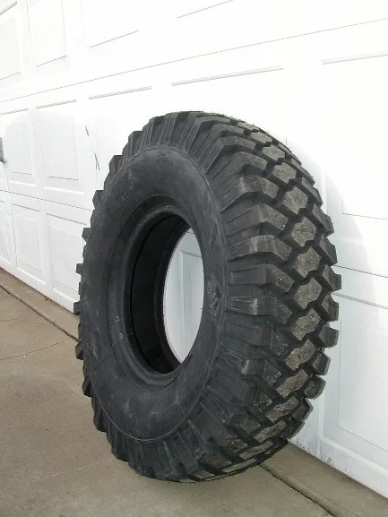

These would be my perfect tire in 9.00 x 16. I ran 11.00 x 16 XLs on my FZJ80 and loved them.
Sidewall information:
Michelin XZL 9.00 R16 Radial
J134 Tubeless
Max Load Single - 3750 lbs at 65psi. cold
Tread - 4 steel plies
Sidewall - 1 steel ply
Denman Coyotes are tall and skinny, but the tread pattern isn't all that aggressive.
my nylon tires(bridgestone jeep service) are good for offroad but no good for the highway. they also go square when sitting overnight. i was told they are not a good candidate for balancing, period!

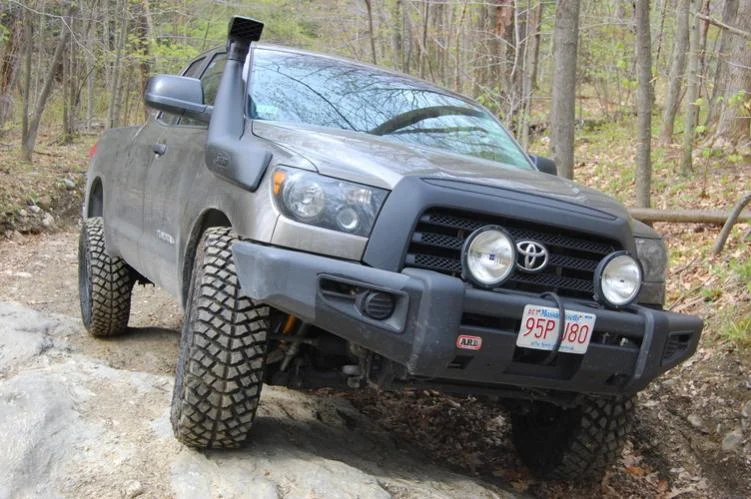

I like the Yokohama M/T+. Some sizes are on the thinner side, but not super skinny. Sorry if I missed it, but what size wheels do you plan to run?
37/12.5R17 on my Tundra. Tread measures 9.8" wide. Feel free to post it if you want, but I don't want to clutter up your 70 series post with Tundra pictures.
http://file.walagata.com/w/bmjowett/tundrahutchinson6.jpg
bjowett I'll post just because that is one nice looking truck. Nice tires
