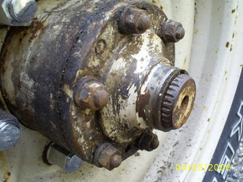

hi everyone.
Theres any afordable and reliable hubs wich i can install in my stock 1978's BJ40 diesel land cruiser ? can't go Warn because they are very expensive where i live( 3 times more than U.S. prices!!!) and superwinch have not local dealer. I been thinking if some Asco (Aisin) hub from any other toyota vehicle can be used in mine so i can buy it from a local junker/ boneyard.
BTW, you can pick up a set of used Warn sine-splines much cheaper that anything Aisin. I sold a pair for $40.
hub picture
itook a picture of my axle.May be this can help to identify what f.....axle/hub do i need.
I'll bet you can trade the drive plates you have for a pair of used Warns.
theres a 70's fj55 equieped with Selectro hubs at a local boneyard. If it is a 1976 thru 1978 year :it is fullt compatible with mine? ia think i can offer my drive plates and add some money for a trade, but need to know if it is compatible because the boneyard ownwer makes no refund he is too creedy and grumpy...that son of vitch

That looks to me like the long axle fine spline - try to get one of those nice Norwegian tourists to bring you a pair from Europe - they're cheap here - look on ebay.de, every once in while there'll be the aisin hubs you need for €29.
