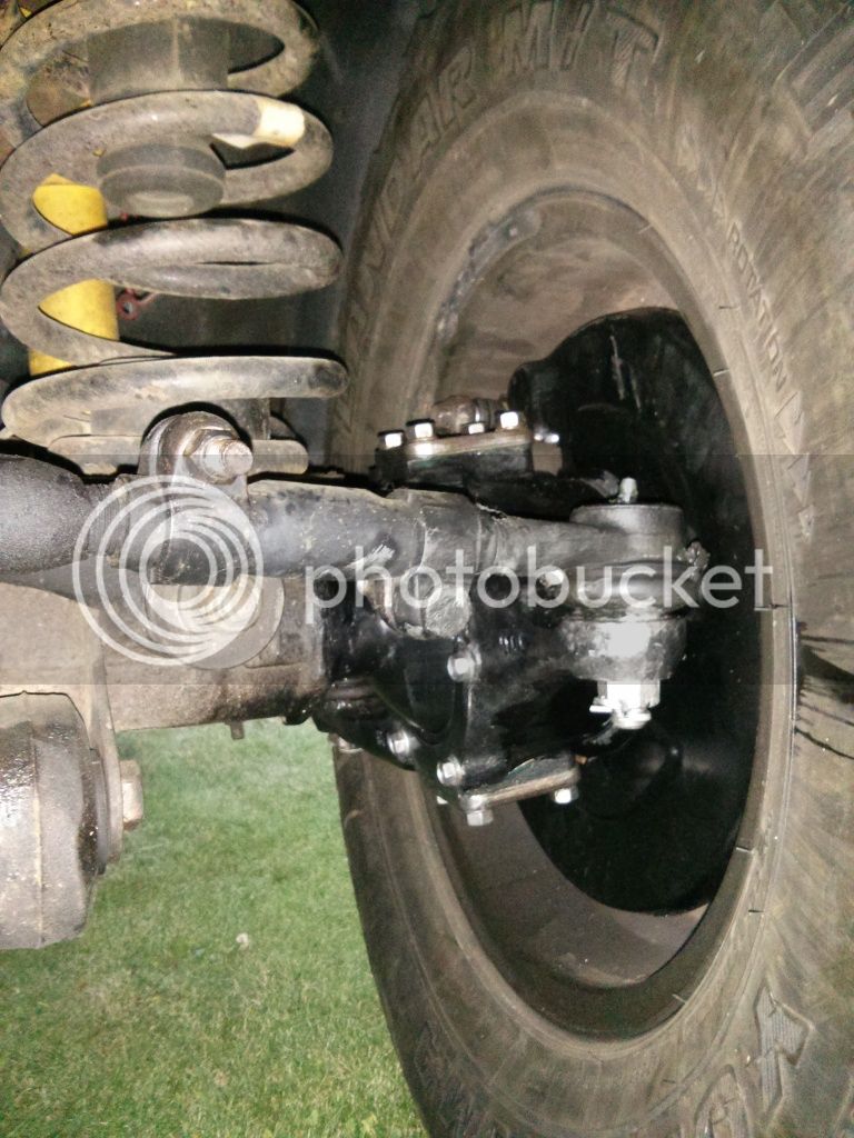

Last night I finished rebuilding my knuckles with new seals and bearings from the inner axles seal back (including king pins). It all started because of a leaking inner axle seal. But the lower king pin bearings were scary. From now on I will be pulling a bolt on the lower king pin bearing plate to make sure they are dry after any water crossing - the same for a bottom bolt on each knuckle wiper.
Anyways, I went to fit the locking hub and now find it is short on both stub axles to get the snap ring clip onto the stub axle splines. It isn't off by much (maybe less than a mm) but enough that the snap ring will not go into the grove. I know the Cruiser front hubs are a bit different but was wondering if anyone ran into this before after a full knuckle rebuild and what the solution may be. According to the FSM, I pretorqued the wheel bearing lock nut to 145 fl lbs. Then backed it off the outer bearing to nothing. Then spun the rotors about 10 circles in both directions and then tightened bit back up to 35 ft lbs. FSM calls for a final toque of 26-43. I do not want to pull everything apart again. I am hoping there is a simple solution. Was wondering if it may help if I leave the locking hub mechanism out, put the covers on, and then just take it for a drive?
Here are some pics...
Stub axle. Snap ring goes in the inner snap ring grove
Locking hub outer brake, spindle washer, stub snap ring
Locking hub components laid out in order
X2... See if you can pull the axle out a bit... Might not be the easiest thing to do when everything is fresh in the knuckle... Also cycling your steering lock to lock can sometimes move your axles around a bit...
Thanks for the suggestions. I got the hubs on. I really had to work the stub axle in and out and spin it. It took a while on each side but now they are on. I guess it was a combination of too much grease (if that is possible) and new components. Now I am struggling with the damn knuckle seal, wiper and metal ring. It came with the metal ring between the seal and the wiper but the wiper is not fitting tight over the knuckle. I am thinking this metal ring needs to be on the outside up against the two split plated that bolt down to hold it in place. You'd think I could find a pic on the internet.

Yes. it is similar on the knuckle. I final was able to confirm on two Aussie sources that the metal supporting ring goes against the housing flange, then the seal and then the scraper.

Got both sides back together Friday just before supper. Looks like new. Did Aircare Saturday morning. Just need to drill out the broken skid plate bolt studs and retap them. Also plan on getting the M55 on asap. I can't take the road noise of the Yokahama MTs. Not sure if I should keep them just for off road or sell them. Went for a short run up Sylvester last night will have a o go out and test it a bit more. Also need to get the winch installed asap. Still dome and things to fix like rusted rear window for and and a few small spots of rust on a side door and rear ambulance doors. I should have watched Louis' YouTube tutorials before doing this job, especially his trick for separating the Bird and then for putting it back together.
