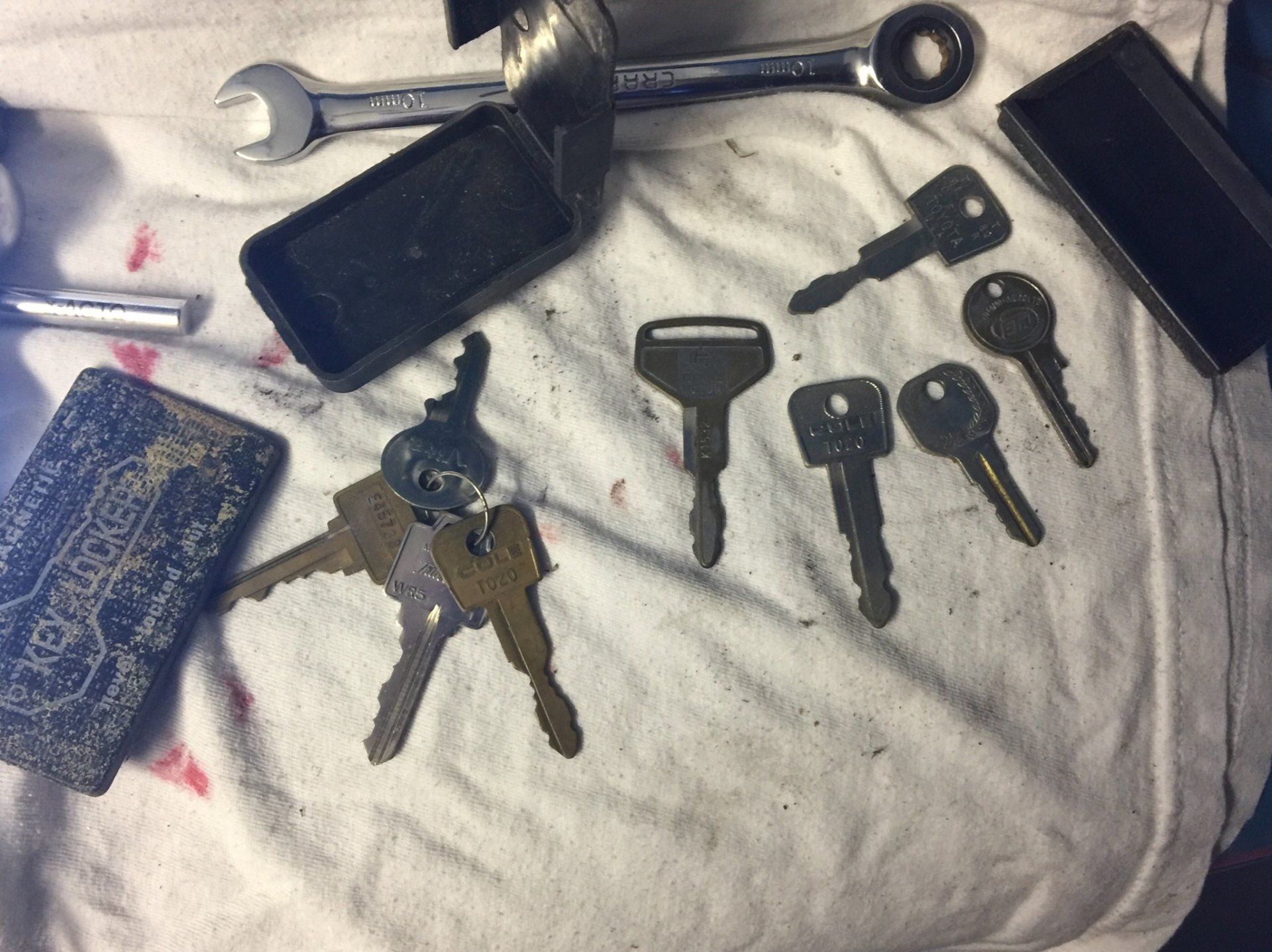

So last night at about midnight I snuck into the garage and removed the fan. I found two hide-a-key boxes.
Only one of the keys worked to unlock the door. Anyone recognize what the others could be for?

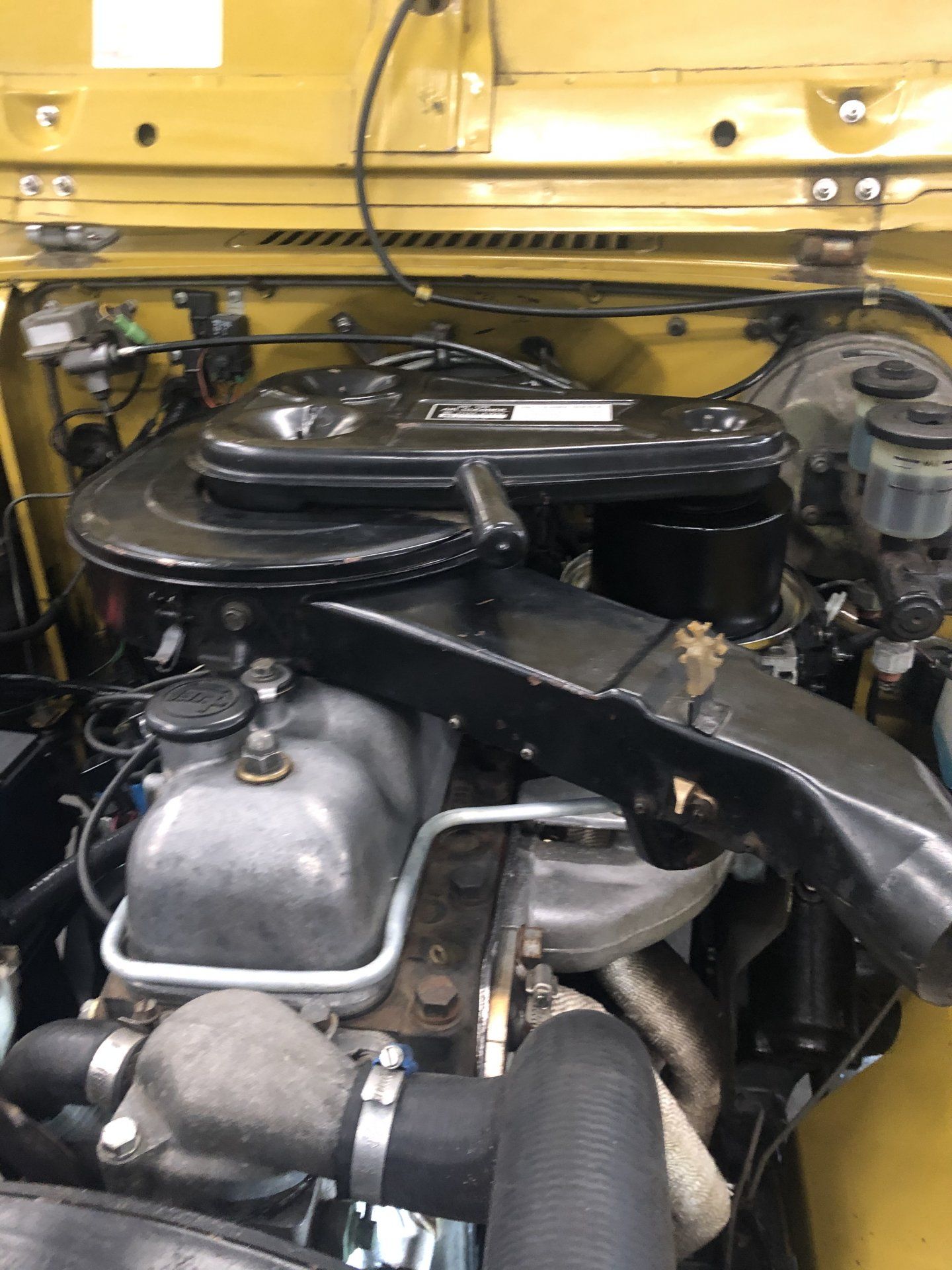

So to stay more on topic, I don’t expect to drive in super dusty environment very often or high water crossings. With that said I always thought the canisters look practical for easy maintenance. Similar style to the Milo2 or the ancient jeep I wish I could pillage in the picture
