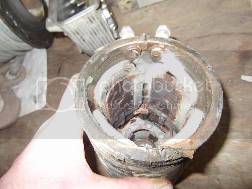

I have a working 8274, but the winch seems to draw way, way more power than it should even under no load. Anyone know how many amps it should be pulling? Can I just take it down to NAPA and have them hook it up to their starter tester? I know how to jumper one so that's not an issue.
I'm going to be pulling the winch and doing a rebuild/checking all the bearings. I already have the lower housing rebuild kit and I'll be using Flintnapper's rebuild thread.

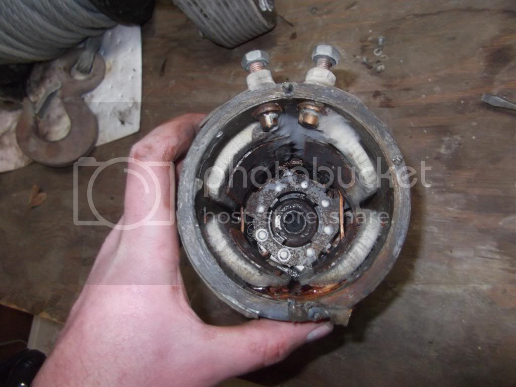

Well I pulled it apart and it all makes sense now
More pics will be posted in my rebuild thread.
However can I safely remove the corrosion from the windings?
