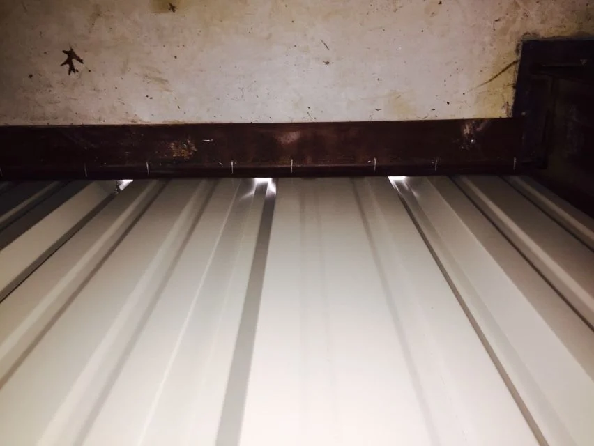

I just built a metal workshop (it's corrugated metal from mueller) and need to seal the bottom where the slab/building meet. to keep out bugs, water etc. What sealant is best? And should this be done from the outside or inside? I ask that because the section that is flush to the metal framing would be difficult to get to if I were to use an expanding sealant and inject in the small area that isn't adjacent to the framing. Sorry for the lack of terminology, I am not a builder. The pic below shows what I mean.

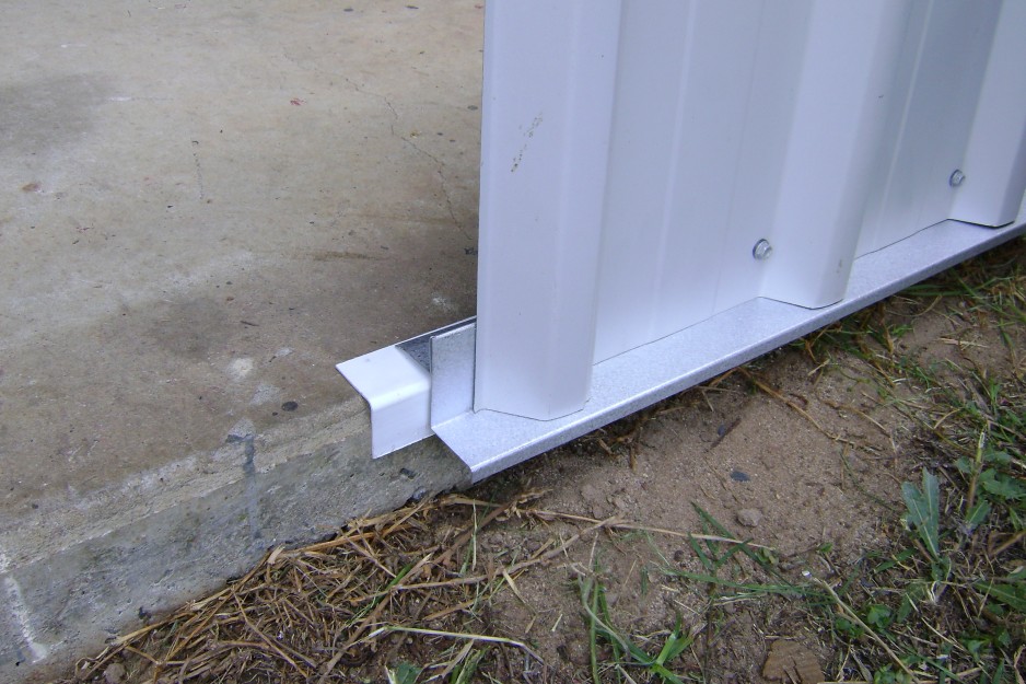

here is what it needed to be like IMO:
Thanks, that was what I was thinking too. Oddly, Mueller didn't mention anything about flashing. I suspect this may be too late though. It sits up pretty high though.

Also some backer rod and silicone on the inside where the raised rib is would help before you fill up your shop. But I would focus on the outside first.
For bugs/air: PBR panel inside foam closure strips, no adhesive. Mueller will have or I can send you a box (300 linear feet per box).
The better means to install is to pull the bottom screws out, push the closure in between panel and base angle, then run screws back in.
If that seems daunting, can separate the "highs" out of foam and tuck in. (Make sense when you see them.)

Most metal building floors are 3" wider and longer and have an 1 1/2"x1 1/2" sheet notch for the sheets to recess into.
Some floors are the even footage of the steel and have base trim, like the picture above, the allow the sheets to run past the finished floor 1 1/2".
Have seen these situations numerous times and, if the sheets end at or above the finished floor level, there's no way to correctly seal for the long haul.

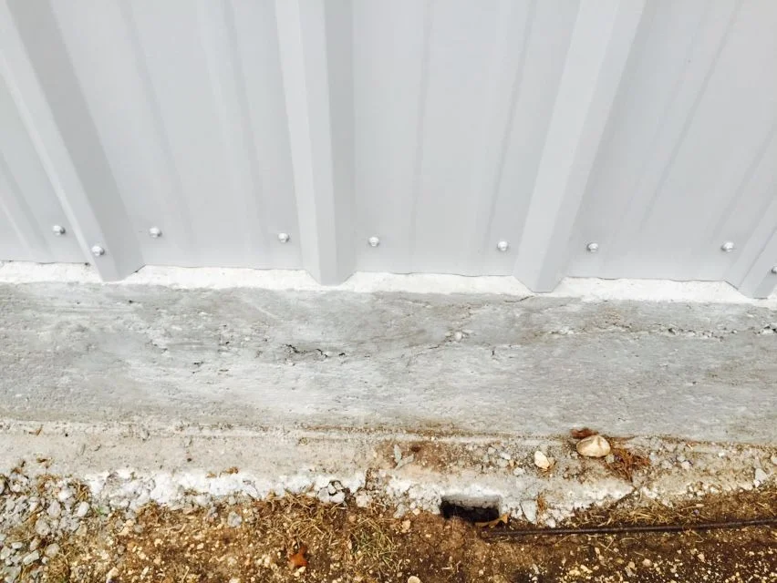

Ok, here are some pics. Yes,the concrete does have a small ledge on the ends, where the sheetmetal sits, which alleviates leaking. At this point, I think sealing the outside is best, but am unsure what product to use. You can see in the two pics the area I am concerned with. Thoughts?

Based on experience and knowledge of this climate, my advice is to tuck foam closures in between panels and base angle and call it good.
Until the building is insulated and probably after, the panels may sweat (condensate) and the foam closures are a better product to expose to moisture, since they're closed cell.
If you caulk it, water may pond at the bottom of the sheets which will speed the corrosion process.
My two cents.
Thanks Chris. Hmm, I need to think about this more. If I do seal on the outside, any moisture would certainly evaporate. I'll contact mueller and my builder and see what they can do though.
