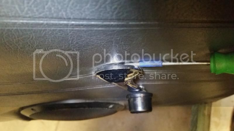

On mine , there is a small wire clip, looks like a big " C ", that is in between the door card and the handle. It fits into a groove on the handle. They sell tools to remove the c clip, but I use a thin piece of steel and pop it out.
Push in on the door card and you will see part of the clip.

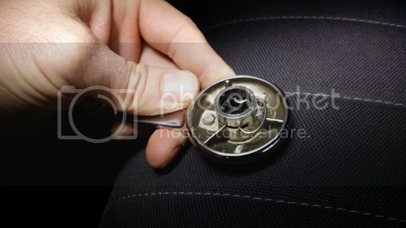

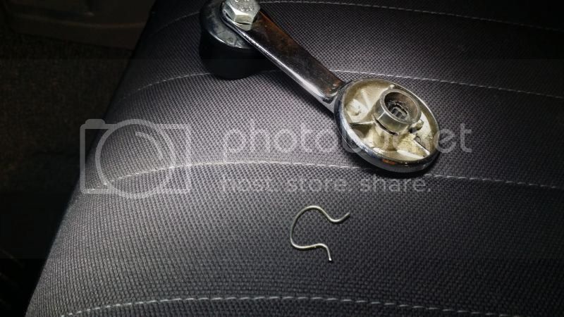

Ok, I'll try. The clip fits into the two slots on the handle. The clip is in between the handle and the plastic shield. By the way the plastic shield can be bought at Spector Offroad. Hope you can see the clip, in the pictures. I use the spring steel strip to push out the clip.
