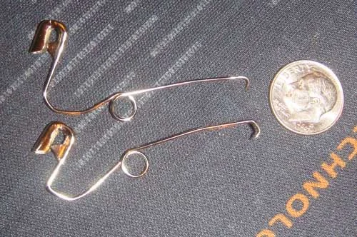

Thanks for your help! The dental pick was the idea I needed.
Fashioned these out of medium size safety pins and was able to get one edge up then get a very small screwdriver tip under it and work my way around while holding the ring up with the hooky doodle tools. Like taking a tire off a bicycle.
