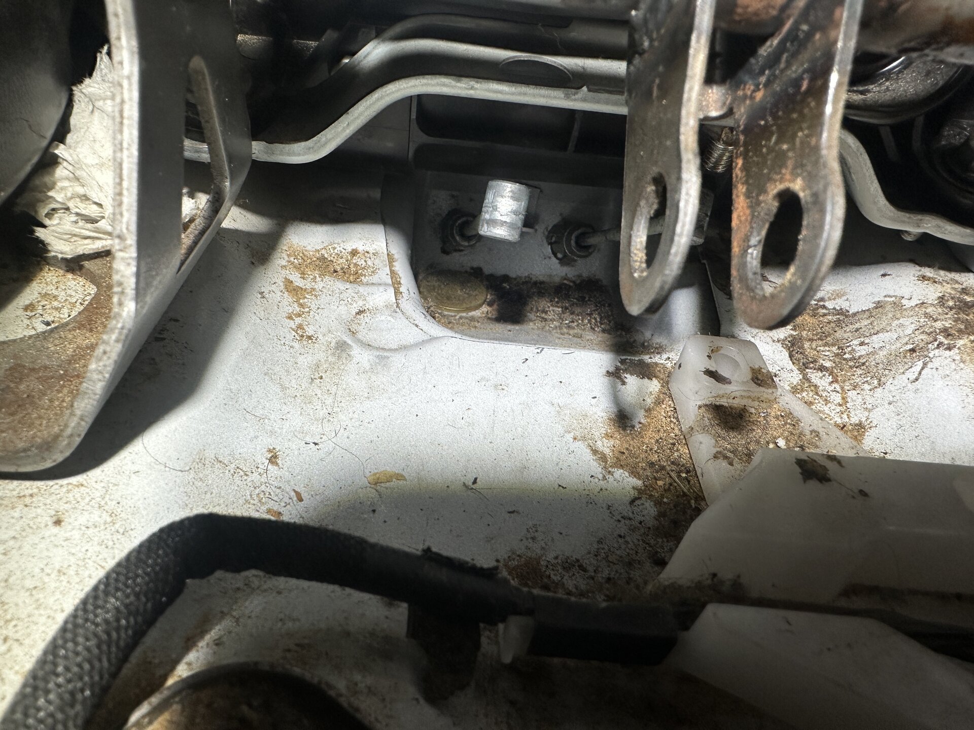

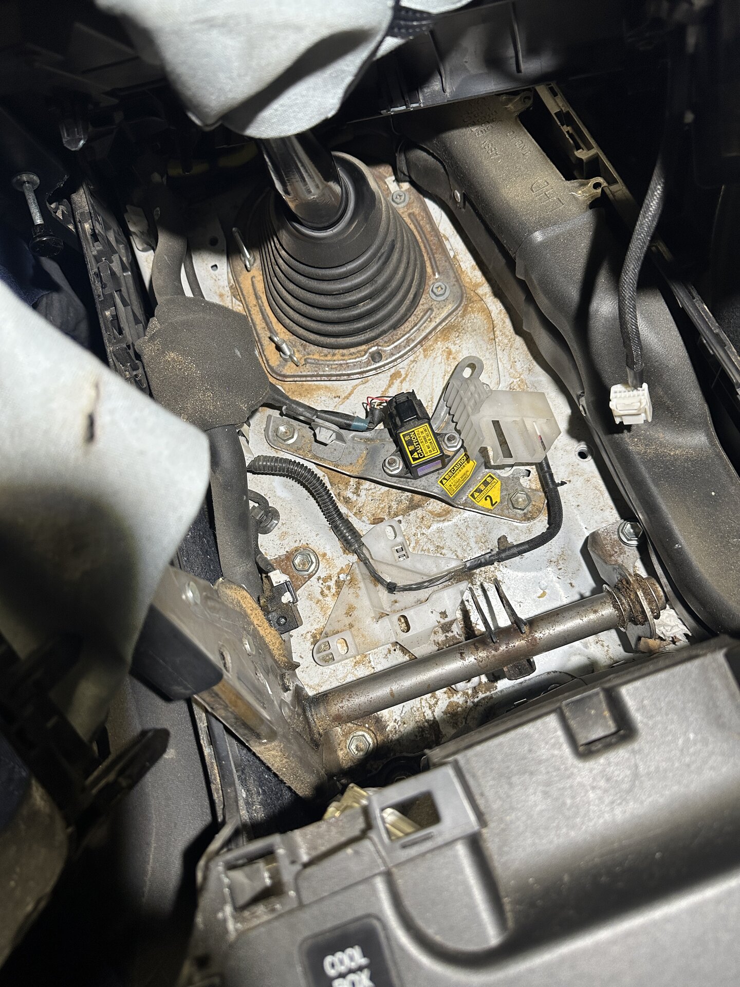

Step one, remove the cup holder and see if I can unmount the bowden. Well the cable itself is removable easily with a 12mm wrench but no chance to dig deeper into it. Luckily you can just pull out the whole assembly in the middle (I guess it is a bit more fun with an automatic but anyway.)
looks then like this (as you see you should never drive with open windows in a sandstorm in the Sahara dessert)
As you see this stuff is fixed in the metal with some nice metal spring thingis…

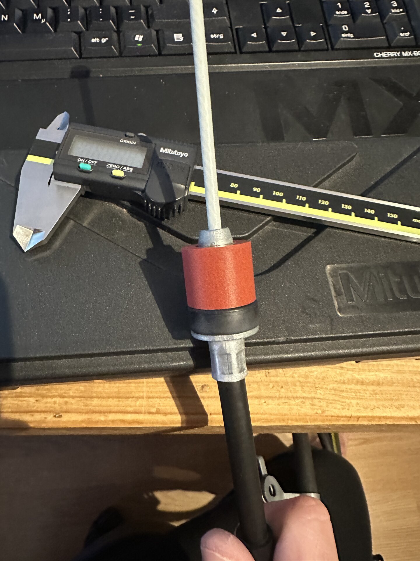

After I tryed it with force I decided to do it with brain so I went to the PC, did some CAD magic and printed an adapter du push the springs to the center
And that worked pretty well

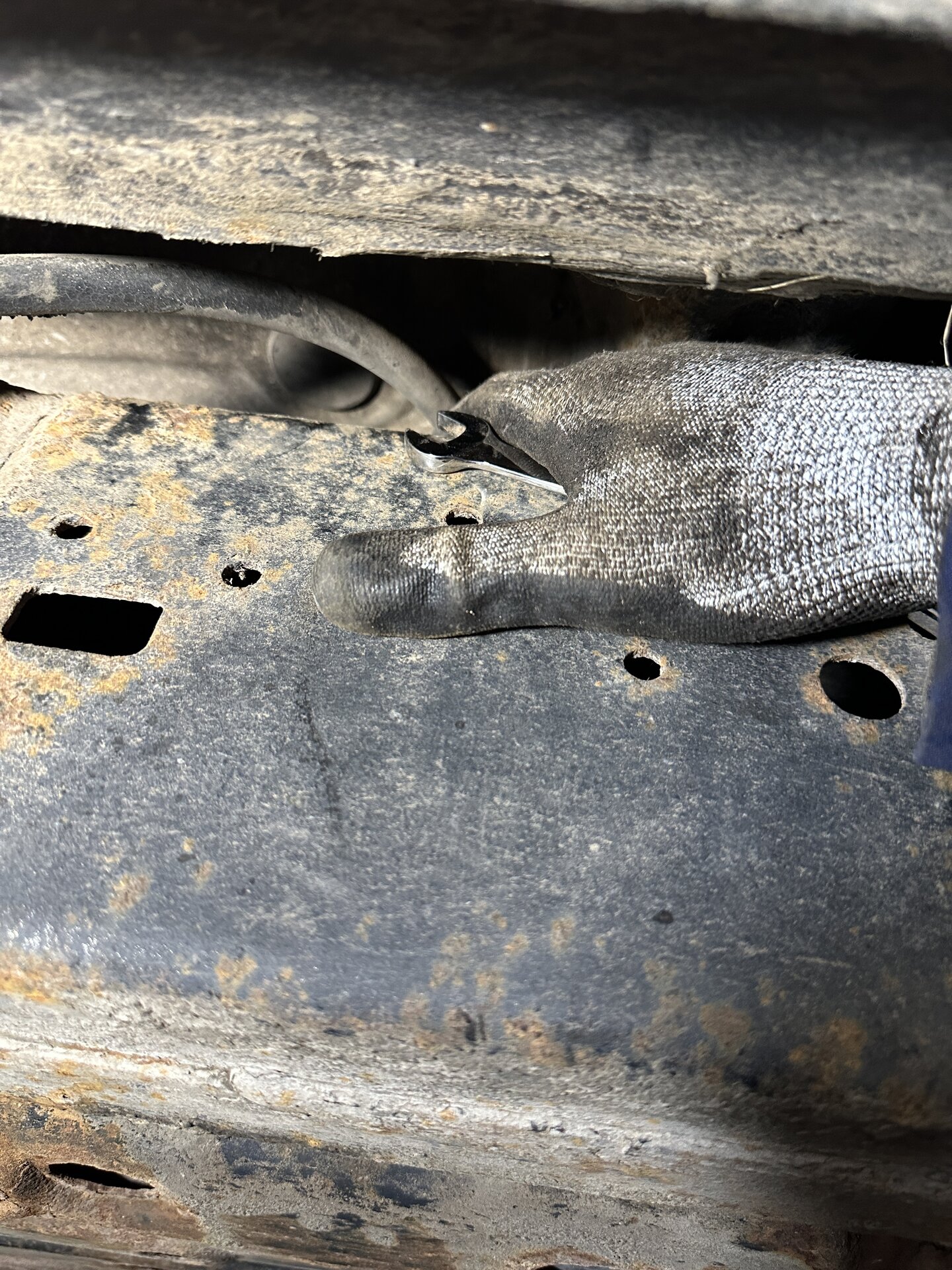

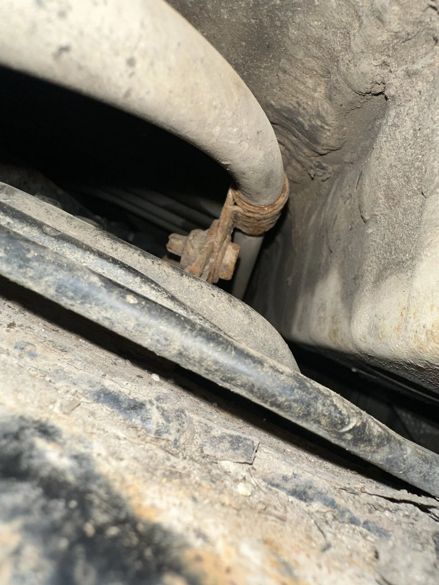

well I thought this would be the biggest step but guess, it’s not! A 200 driven in southern Germany that got no care except the basic technical stuff and every 6.000k fresh oil has alot of rust and so are the screws of the assembly.
Tried to remove the second screw and I got another screw head for my collection. 🥲

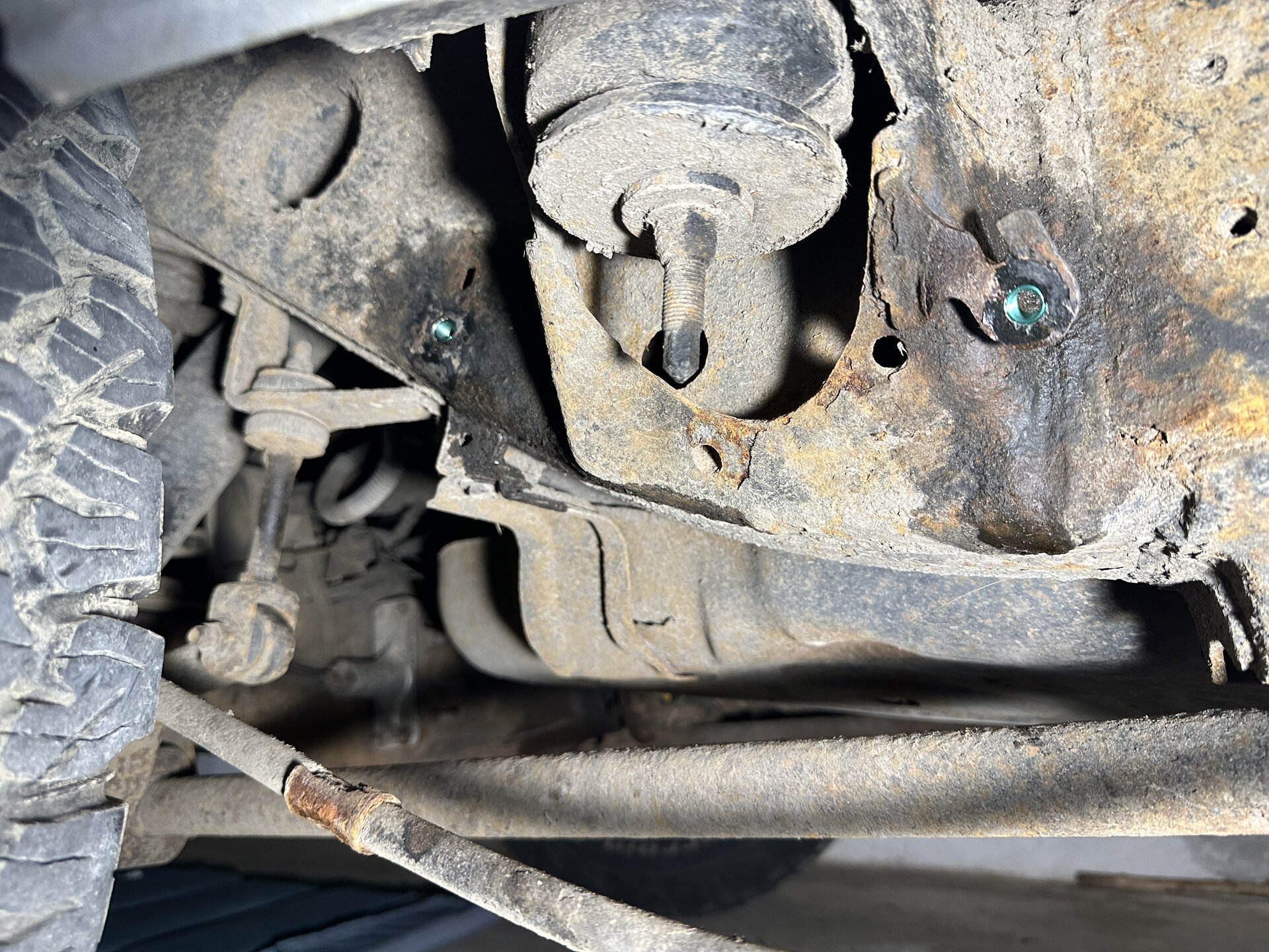

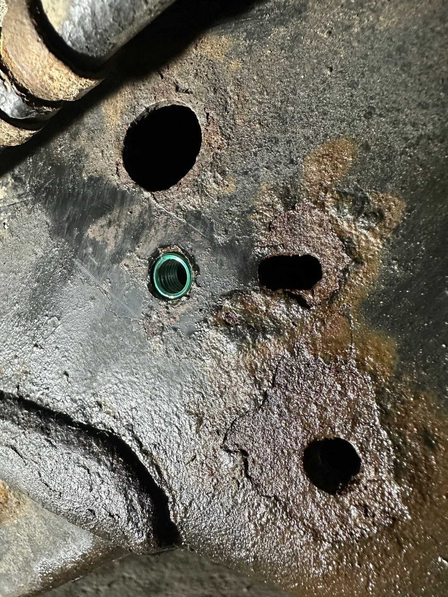

Worked on the passenger side today. The helicoils did their job pretty well and I glued them into the frame with green loctite.

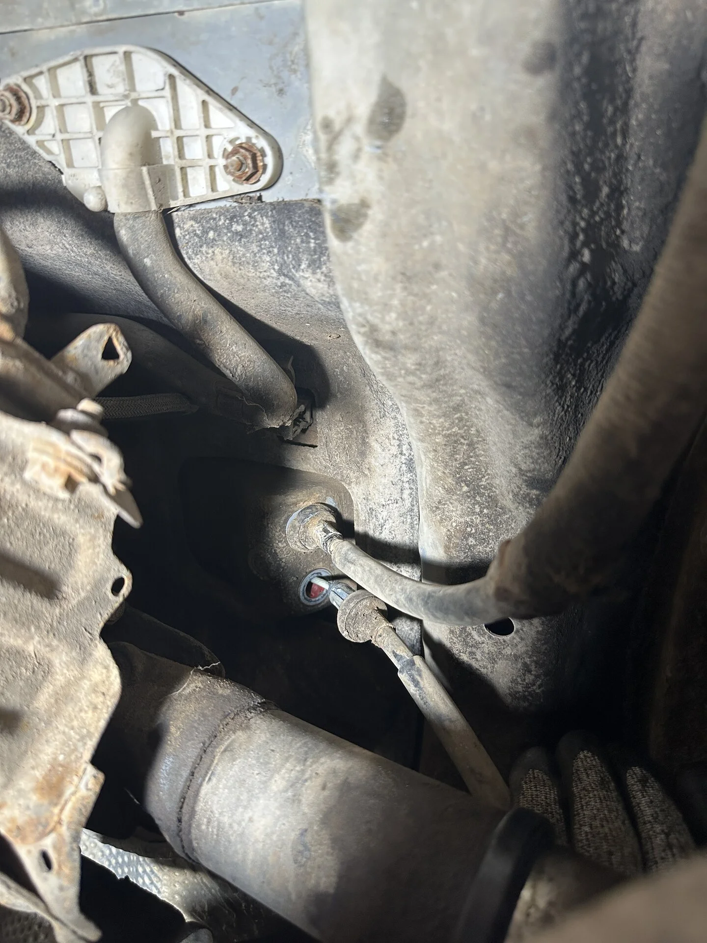

Thought I removed all screws (the one close to the diff is hard to reach) and saw that Toyota thought it is a good idea to also place one ok top of the fuel tank…in the middle of it…
This one will be tomorrows target. In the worst case I just use a grinder and cut of the bowden before and after the tank 😤
yes my frame is in mint condition like fresh out of the factory.
And here the last screw on the passenger side directly above the tank.
