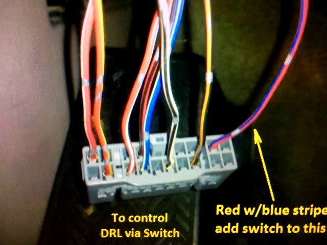

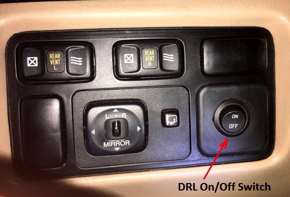

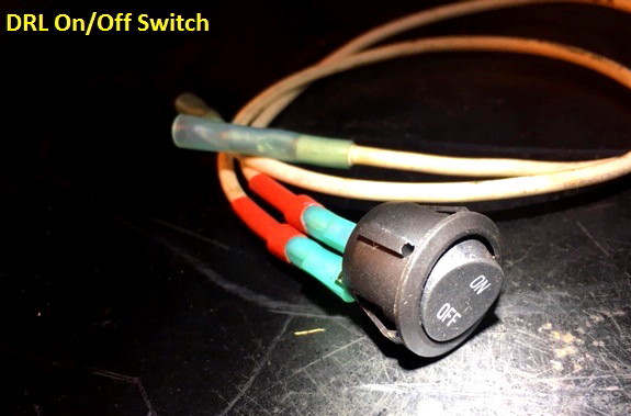

On my '99 LX I just added a switch where I could turn the DRL's on or off. Don't know if the wiring is the same for other year models.
I'm running Stedi Copperheads in both my high and low beam positions. If I recall correctly (from another thread and mentioned a couple of posts above) I just cut the red/blue wire under the steering column. I was going to de pin it but my patience ran out and there was enough free wire to splice it again if I ever need too. I also have a 99 (LC).

If your interest is in disabling the DRL you won't need to access the fuse panel, just temporarily remove the connector (under the steering column) and address the one wire associated with that circuit and plug the connector back in.
