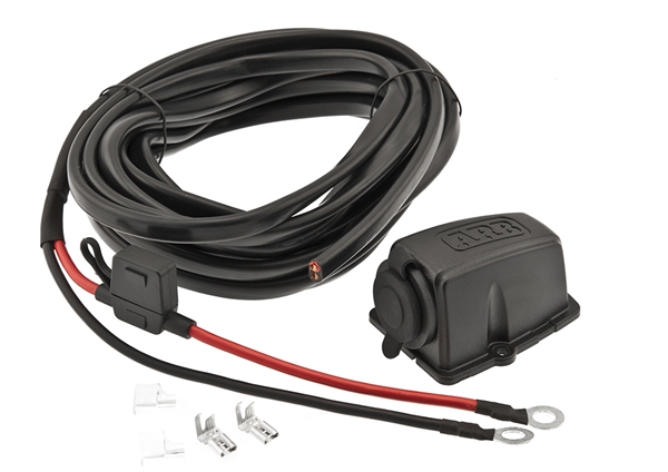

This is a great option too and you don't have to ditch the factory plug.
ARB FRIDGE FREEZER WIRING KIT & THREADED SOCKET (10900027)

The Wits end plug is nice but I don't need a coil. I believe what plugs into the actual fridge is the same 2 prong plug. I do have a blue sea fuse box and breaker with Anderson connectors waiting to be installed.

For $40, the ARB threaded outlet is a real no-brainer and the install only takes about 30-40 minutes. The ARB plug transforms from standard CIG 12V to threaded in a matter of seconds. Also worth noting is that it comes with really heavy gauge wire, heavier than any standard CIG 12v outlet has running to it, which will affect efficiency.
