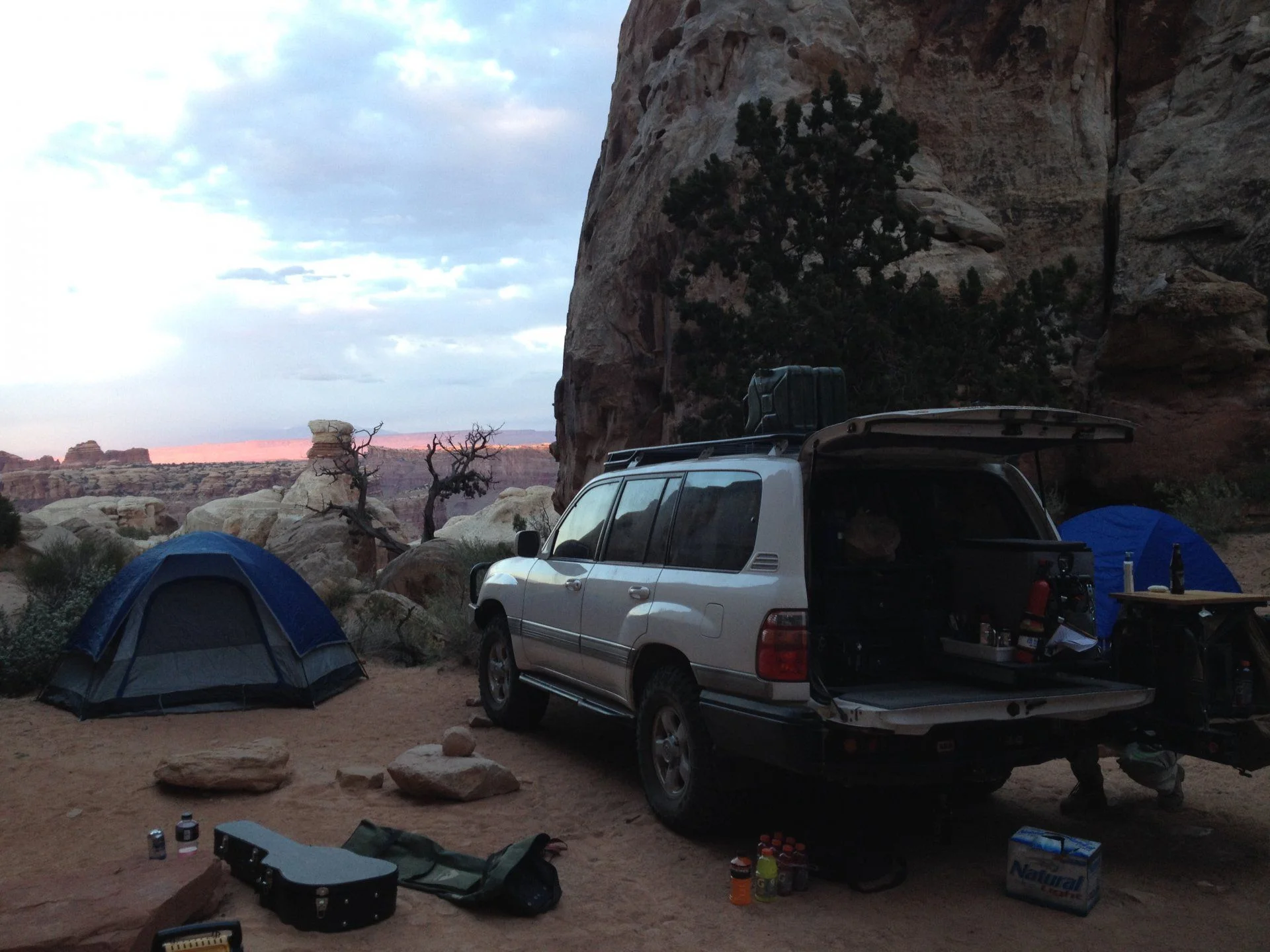

Hit me up if you want to borrow a Rotopax or 2. here's your Dollhouse shot... :)

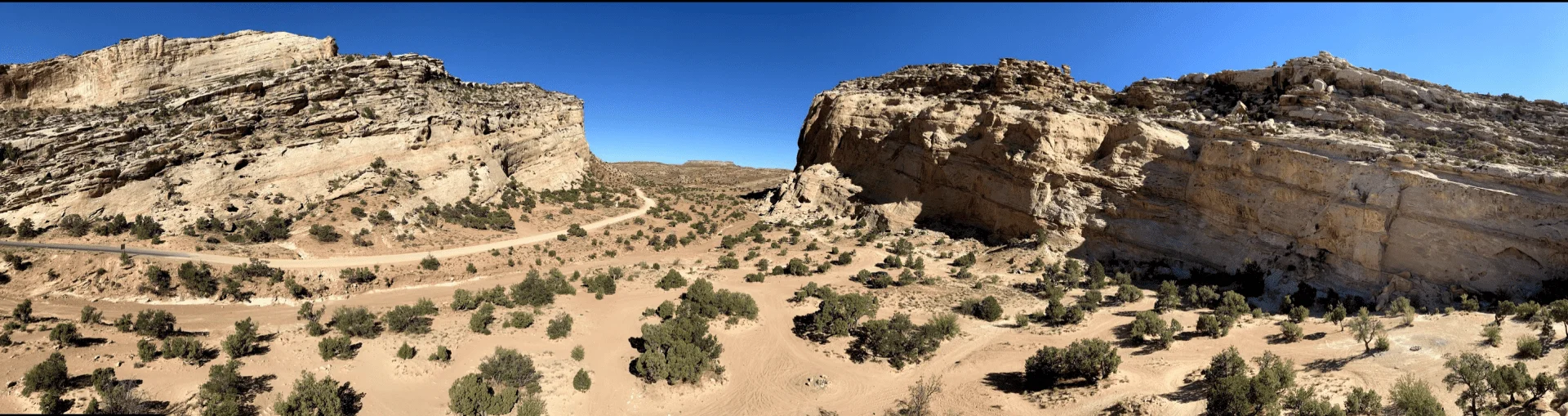

If you’re in Hanksville, you should check out Little Wild Horse Canyon (free slot canyon hike) and Goblin Valley SP. I can pm you some more maps and directions. Here was our campsite near Temple Mountain Wash, nearby. LX and tent are center right, behind a tree.
thanks for the advice, if time wasnt such a problem hite or even hanksvile would be a game changer. Im expecting the worst of road conditions and if doll house really is 6 hrs from hans station? Interesting youre in broomfield i work on 116th.
Will take that advise! black cruiser? that picture does no justice.
No, it's barely visible - light blue LX. Orange tent. The scale throws you off because the area's so big. About 1 o'Clock above the fire ring in the center bottom.
