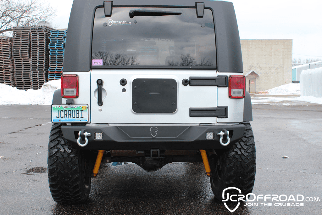

I've heard this comment multiple times, and I always thought door opens towards the curb because the vehicle design was intended to serve other markets. But I realized that the Jeep Wrangler rear door opens in the same direction, and that was definitely designed for the US market. So I'm still at a loss!
Good catch. THat Jeep barn door looks much narrower than the GX back door.

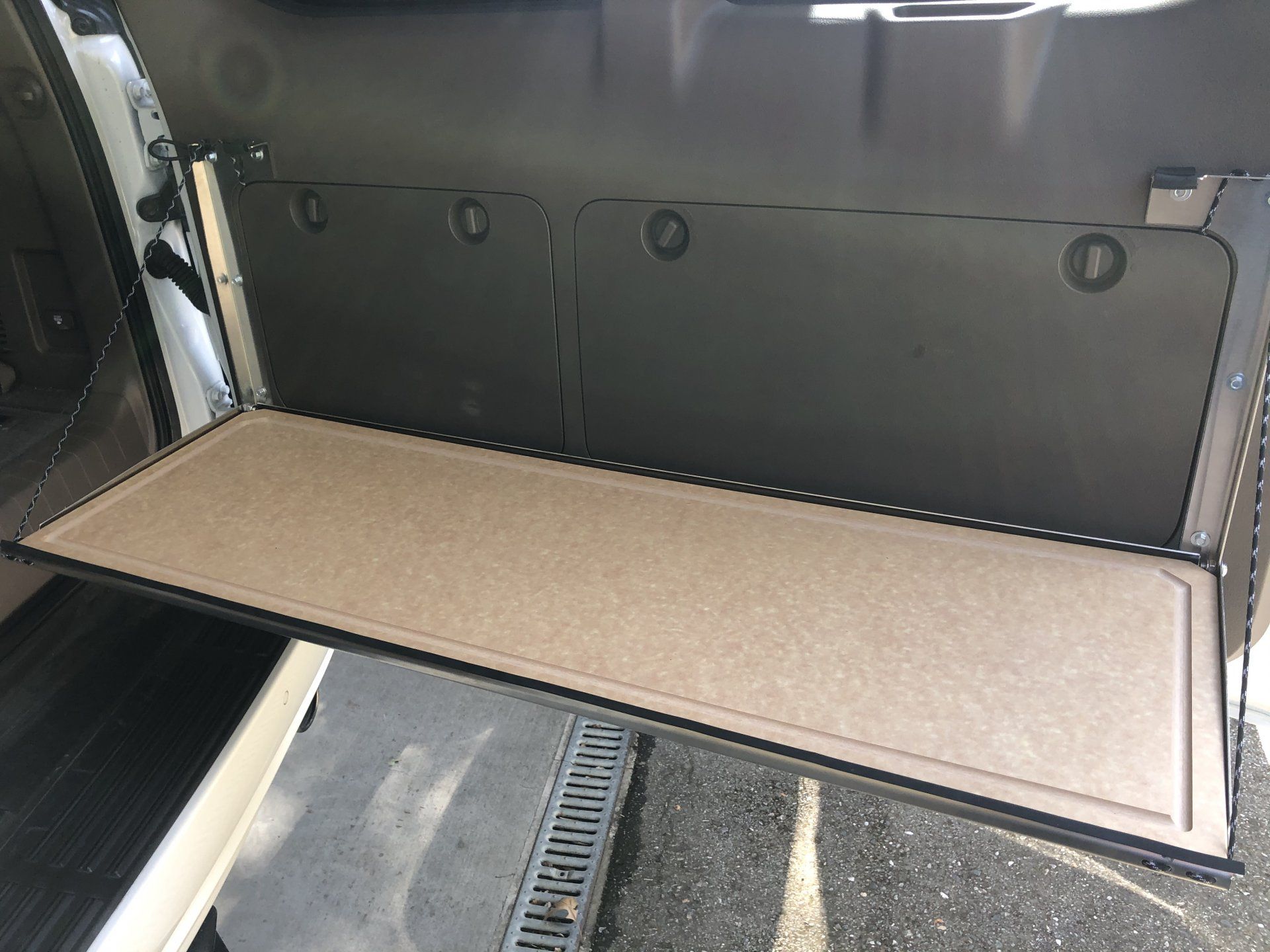

I hated the barn door until I installed a table on it a few weeks back. I picked up a bad brisket smoking habit while living in Texas during grad school. Now I can bring one with me resting in a cooler to serve at tailgates and picnics - made easier by the richlite insert on our Kaon table with a big juice groove. Other side is flat so we can just flip it over as needed. I need to work on some overhead lighting on the door.
Very nice! Who made the insert for you? And I agree that the table totally transforms ones opinion on the utility of the barn door.
It was made by Cuttingboard.com. It’s just over $100. I used 1/4” richlite and specified bullnose edge with juice groove. I have 3/8” rubber pads underneath to space it up. You’ll have to cut off the back corners to clear the pivot bolts but that took 3 minutes with an angle grinder and polished smooth with a flap wheel sanding disk on the same tool. Or they will cut off the corners for you for $70. I can post exact dimensions if you’d like. I wedged some rubber molding at the back edge to hold it in place and it folds up perfectly and doesn’t move or rattle.
I've always thought using a bio friendly material like Delrin, or as used Richlite for an insert for the table was the best way to go!
I wouldn't ever used wood because too much odor and stains, especially if you're camping in bear country. You want to be able to keep that insert as clean as possible!
