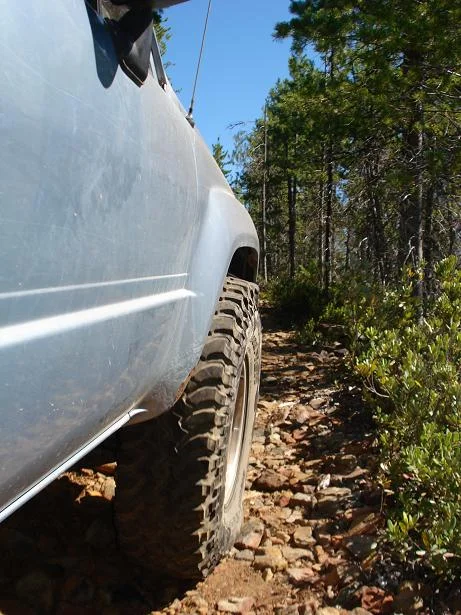

I have my 33X10.50's on 7 inch rims with 3.5inch back spacing and this is what the front looks like:
attachment.php
Mine are MT's, but the AT's should be about the same, only at 9.50 a half inch in or so....
attachment.php
The rear stuffs into the wheel wells just fine with a little rubbing on the front edge of the fender....
After looking at the rear tires today, the edge of the tread is about a half inch inside the fenders while it's on flat ground, the sidewall sticks out maybe a half inch past the fender..... Make sense? :D You can see the front sticks out a bit more in the firsts pic. So with 9.50's you could probably go with a 7 inch rim with 3 inches of back spacing to get close to my setup.... :cheers:
