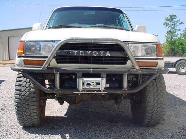

You figure out a way to build a bolt-on rock bumper and you'll sell some steel. Those of us with custom fabricated rock bumpers had to cut frame ends and move parts out of the way to accomplish better approach/departure angles. 95% of Land Cruiser owners will never put a major aftermarket part on their vehicle. 75% of those that will, need bolt on parts. Most of the rest of us build our own crap because we like to build our own crap. The market for parts that require altering the vehicle frame or moving things around is pretty slim. That being said, anyone who wants to put more choices on the market has my encouragement.

not finished yet,and its bolt on.

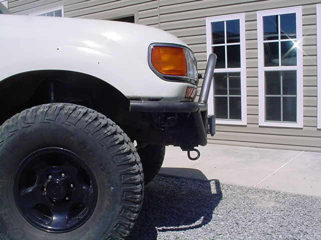

I think it depends on the need. Myself, not having any little punks (yet) to drag along with me, I prefer more of a self contained setup. Travel light, avoid as much weight as possible, spare mounted in the cargo area, etc. The rear bumpers available don't appeal to me personally. I really like the idea of some simple, nicely designed, bolt on wings that would hook right up to the frame and the rear crossmember that's already there -- something similar to what BRKLYN1 showed in his ROTW. Seems like it would help keep 2 things to a minimum - cost & weight. I think there's got to be an relatively simple way to avoid the massive rear bumpers. As far as the front goes, I think the ARB fits me perfectly. My part of the country is heavily wooded and full of deer. Before the ARB I broke a front marker light assembly navigating between trees - all it took was a very small branch hanging out. Again, this is all opinion, I certainly respect the views and needs of others, which btw are apparently the majority as that is what many of the products cater to.
