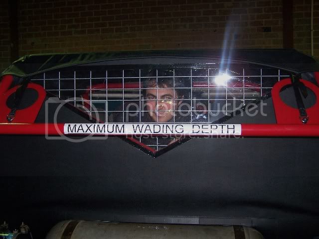

Yep custom made $100 and 2 bottles of bourbon:grinpimp:
This top is in two parts, you can just see how the top over laps the wind jammer with a full Velcro strip across the back along with the two tension straps, in side there is a row of little ties that fix to the cage too to keep the wind jammer taught, down the sides just above the side view windows is also Velcroed so it can be used as a wind jammer or a bikini top and together to make a whole roof.

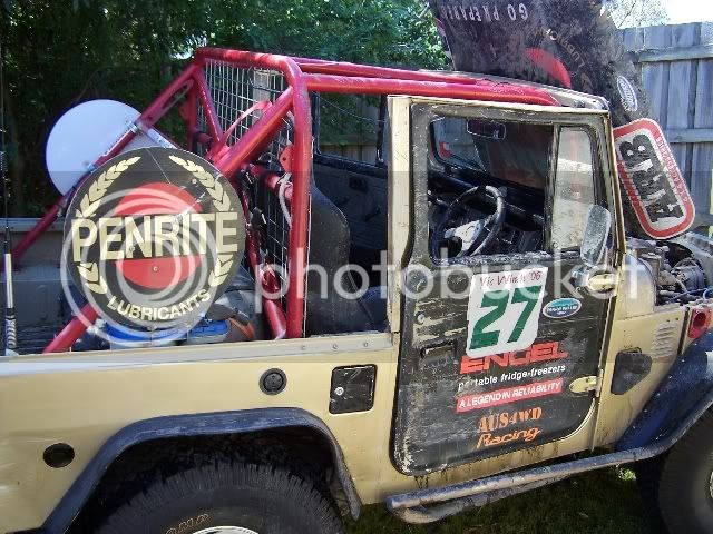

I just put the angle grinder through a perfectly good rust free side panels and cut the door frames out of it:D
I cut the out side longer than the inside and folded the edges over.
The cage forms the rest of the frame along with a bar between the top of the two door frames over the cage to tension the roof.
More photos on the link below for My Space
Thanks for the pics, are the door frames attached to the cage in anyway or do they just float there?
