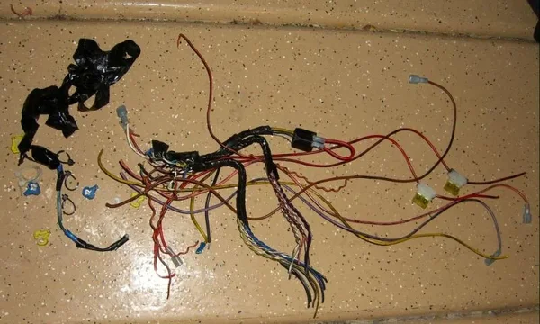

No,,,, You have double checked all cables ?? esp one going to your starter solenoid . when you do get it to do it , you need to see exactly what is going on AT the starter.... is your small lug getting 12 V?? that wire is the extension of the blk/whit under your dash (that your RS connects its violet wire to) Doesn't look like you have a starter interrupt installed at any rate from your pictures) If 12v is good at crank position ALL the time on the llittle lug- prob lies at starter- this is not a guessing game
Which is why i informed you weeks back that you had not gotten to the real source of your prob.
These are the spare wires from my ignition interruption removal :hillbilly:
