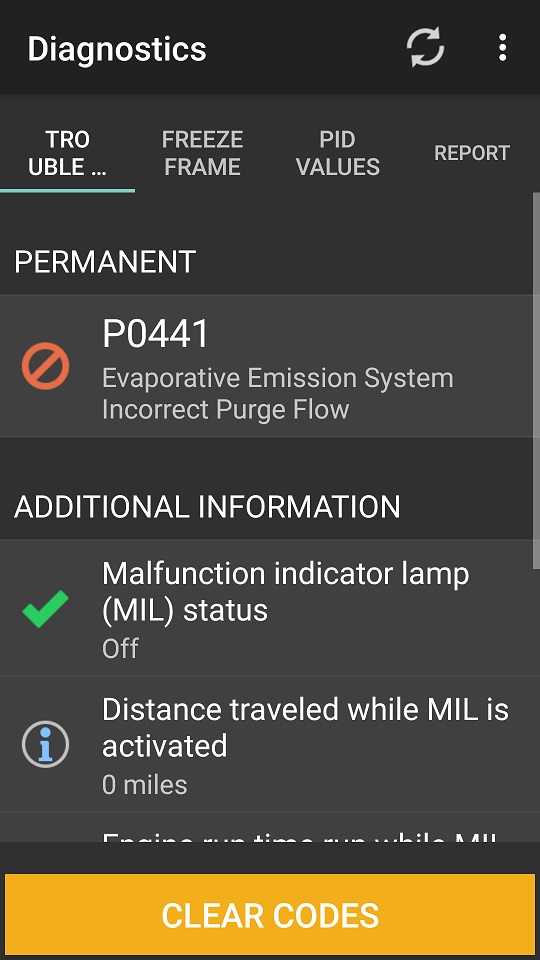

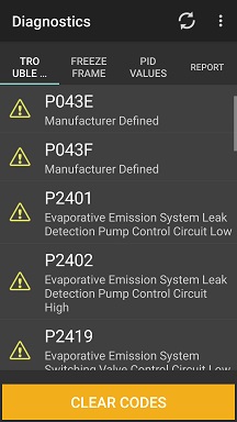

How can I clear this code?
No engine check light.
I would think you can clear it using Techstream if you have a cable and a laptop
I dont think you can clear emissions codes, they go away on their own after a certain number of passes, 3 I think.
Thanks .. I'll try the 3 trips and my friend has a tech stream.
