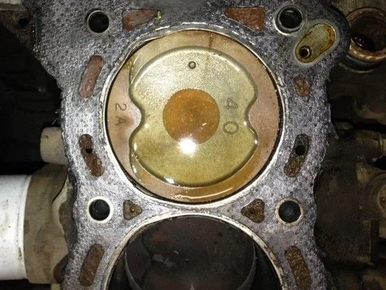

The half gallon of coolant is a sign in my opinion.. But if you live in a cold climate you’ll have steam coming from your exhaust a lot on startup. It’s just moisture.
Not sure on the rough idle. Might just be quirk if the truck. All cruisers I’ve been around have them.
Mine will steam white for a good while until around 130f on a -15C morning. Once warm it still is a little wet exhaust but It’s clear.
It's never put out this much steam. I've had the truck for ten years. I think the initial misfire on startup is because of water in one of the cylinders. I'll pull the plugs for inspection when I get a warmer day.

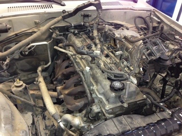

Blew my HG back in 2014 towing my popup... knew it immediately, limped it back home 50 miles pulling over every now and then to prevent it from overheating adding water to Rad a couple times iirc. I bought the Toyota OEM HG Kit, Toyota Rad Fluid, new belts and hoses, etc. and got started within 2 days as it was my daily driver at the time...
I removed the hood, air filter assy and any other items that prevented me from sitting in the engine bay to remove things (2.5" OME lifted)
I had the Head and Intake assy on the bench by that first evening, spent that night and the next morning cleaning everything up and it was back running by day 3 (albeit long days).

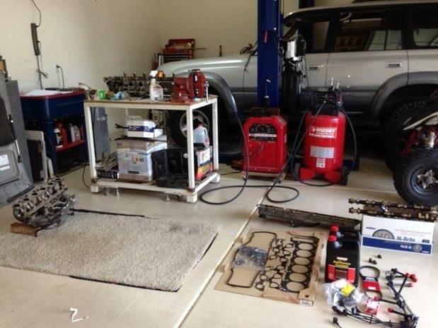

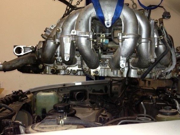

I did use my Bendpak car lift to remove the head and intake assy as one piece but that could be done with an engine hoist. To stay organized, I ziplock bagged and tagged every set of nuts and bolts and misc brackets I removed keeping them in the white box in last pic which made re-assembly much easier. IIRC, I did use the car lift to tighten the exhaust pipes to the exhaust manifold. I would think under normal circumstances, most folks could get it done within 3-4 days or a couple weekends if they were motivated to do so... since you mention age, at the time I was a spry 48 yr old :cool:
