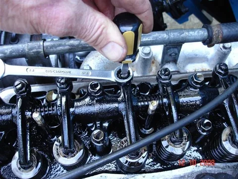

I've experimented on my B-diesel and found NO difference at all between hot and cold values (by checking clearances as soon as I can after stopping my engine and then rechecking them later after it's cooled completely).
So I am happy to set my clearances to "hot specifications" while it is simply "warm" or even "cold".
Really ...... How can one measure HOT clearances? (By the time you have the air cleaner and valve cover off ... the engine has already cooled down from HOT to WARM.)

Must be quite a different setup (overhead cam?) compared to what I have on my B-engine because the only shims I deal with are those in my toolkit (that I use to check my clearances).

Maybe all this varies depending on which engine you're working on? (Mine's an old "industrial-style" engine :D)

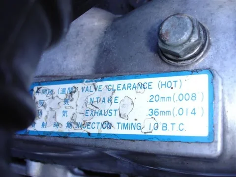

If it must always be done "stone cold" ... then why does Toyota supply "Hot figures" on an engine like mine?:
:beer:
AFAIK ;) the HDT has an overhead camshaft and is more or less identical to the 1HZ (or the 1HZ to the HDT ;) ) and shims are used to adjust. Is a bit of a P I T A but wear is minimal.
And the adjustment should be done when the engine is cold....
I don't know your engine but a play of 0.20 (in) and 0.36 mm (out) when the engine is hot looks to me as being a lot. I would guess these are for cold setting although the decal gives the impression these are hot values.
