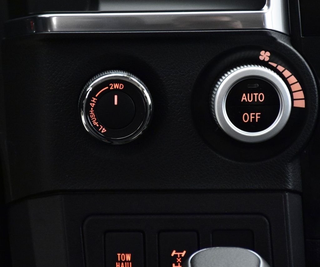

When switching the Sequoia dial from 2WD to 4H, the transfer is placed in AWD. 4H doesn't lock the center diff. There is a Torsen T3 center differential, just like the LC 200. If you look just below the dial, you can see the center diff lock button. The Sequoia is arguably based on the 200, they share many parts.
I understand but the argument is that the LC is already in AWD but the big tree is not until switched there.
