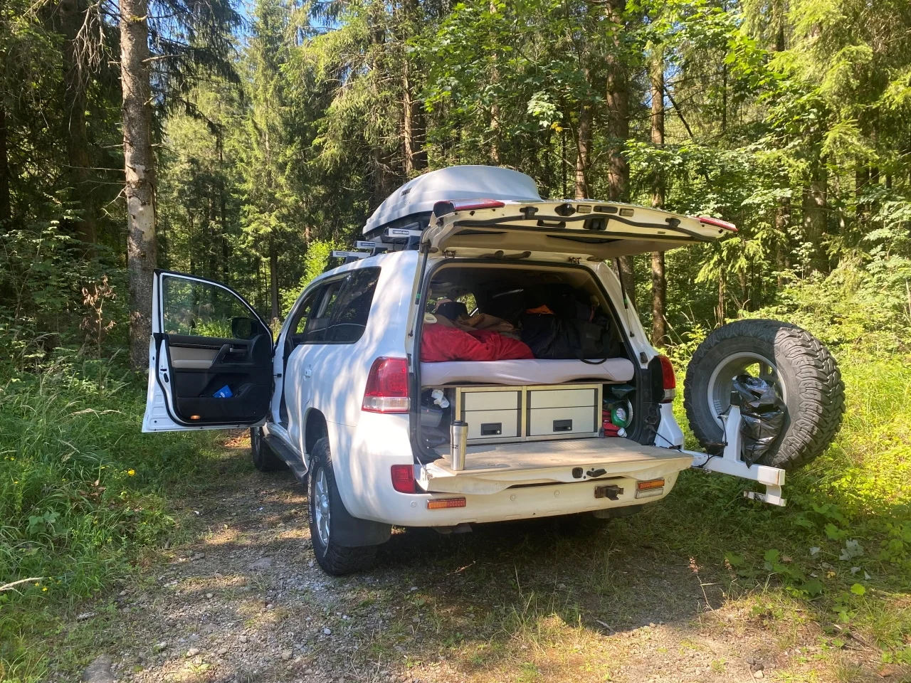

This is my hot shower setup since 10 years, by using a heat exchanger to get hot water when the engine is running.

Guess it doesnt matter if you sleep inside or in a rtt - you dont have that much space left :-( Here is a view into my rig:

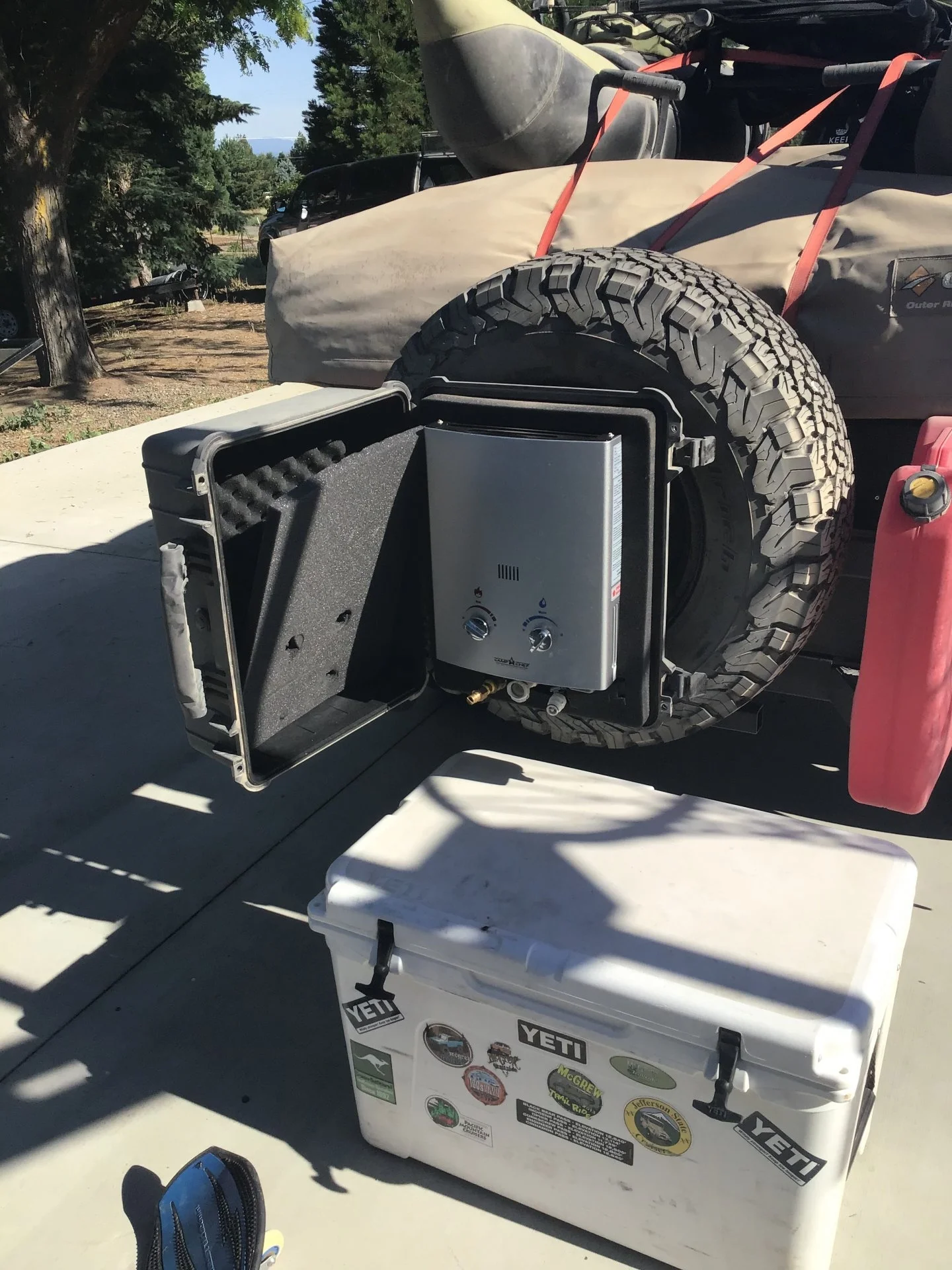

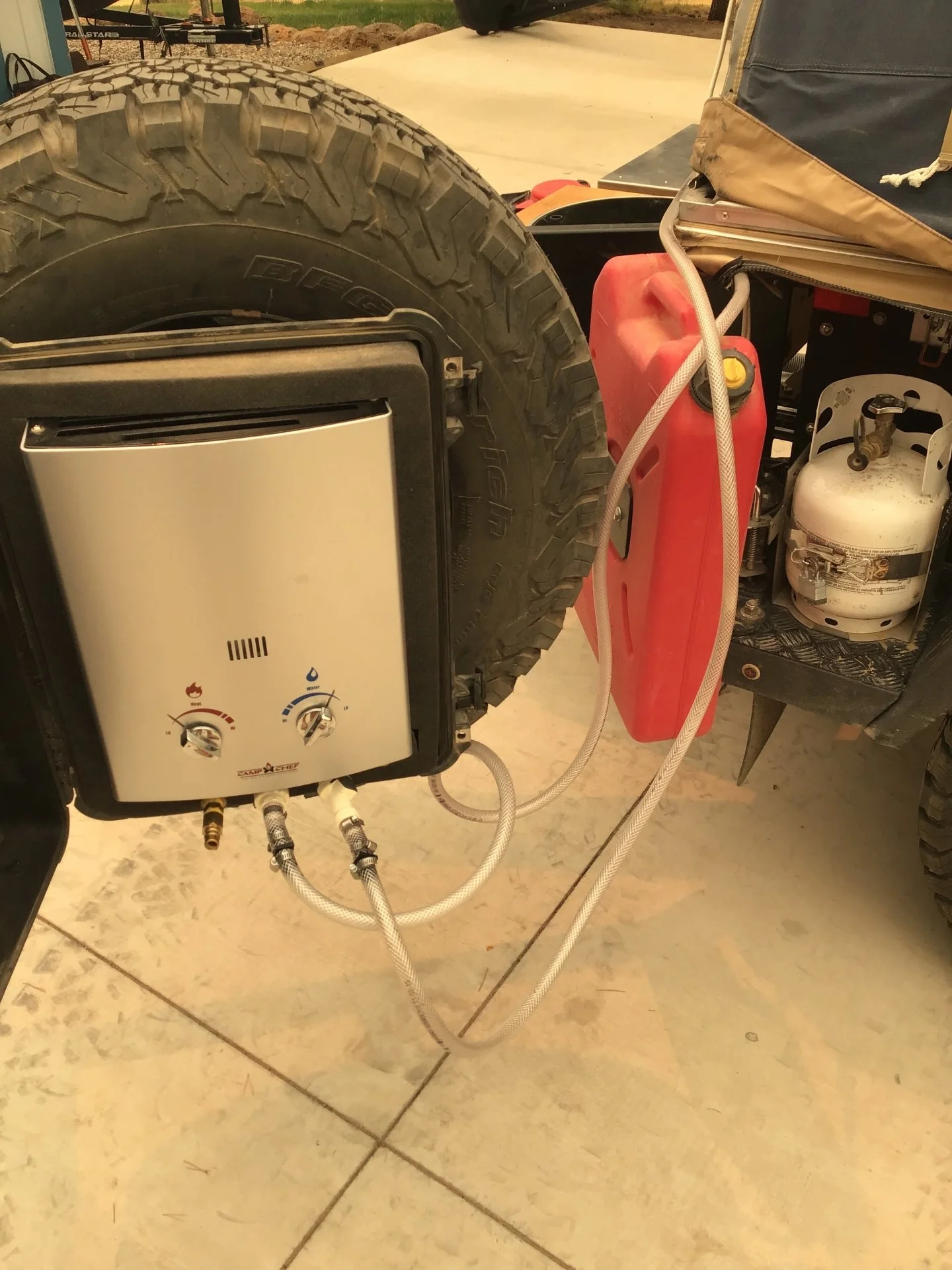

So I had some inquiry on my hot water set up on my turtle back trailer so here it goes.

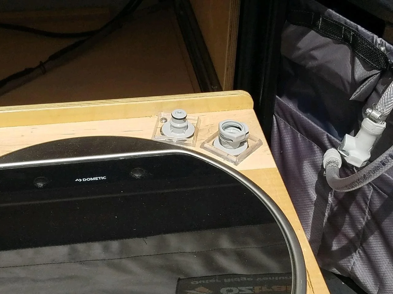

I used 2 quick connect water pressure fittings behind the sink, link tech male and female. Used on the water heater as well.
The case is a pelican 1550, water heater is a camp chef.
2 food grade quality lines for hot and cold, between the sink fittings and water heater.
Too mount the case and water heater, I used the gamiviti spare tire mount and quick release accessory mount. Also quick release propane connections.
I also have an extend shower hose to get it away from the trailer.
Only issue I have ran into is the factory welds on the water heater bracket failed. So I had to fix that, no big deal.
This one is easy to use in a pinch. Not as much hot water flow but better than ice water. Cheaper and easy to pack. Mr Heater

Bumping an old thread, but I am building a similar set-up for my offroad trailer in a 1550, and a couple questions: Any issues with the hinges carrying the weight mounted in the lid after time? And second issue I'm concerned about in my build is the heat venting, so I spaced it out 1 1/2" to allow the unit to fully vent while it's running. Looks like you didn't, so any venting issues, plastic overheating? Anything you mighta done differently after using it awhile? Thanks in advance.
So no problem with hinges, or venting. It has worked flawless. The only thing I had to modify was the way I mounted the heater, over time the cheap mounting tabs broke after miles of wash bored. I had to actually mount the water heater using the external skin of the water heater.
Other than that no other problems
