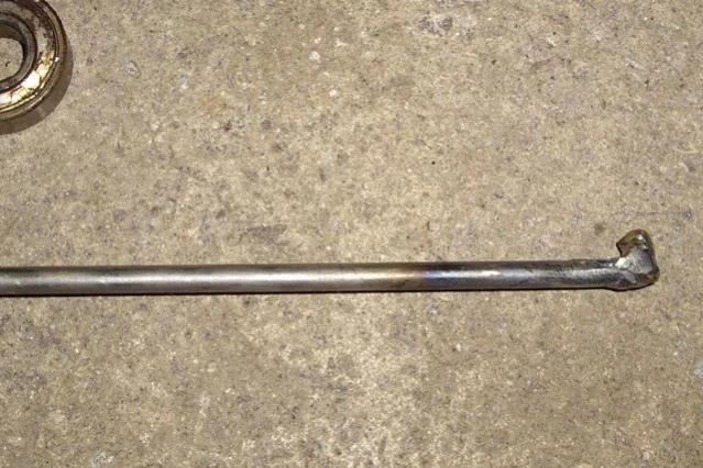

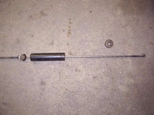

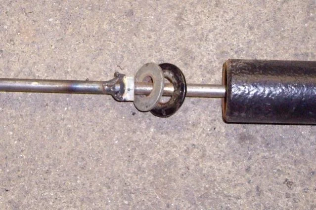

Materials:
1. Round stock rod
2. spare nut
3. two or three washers
4. tube
Directions: weld some extra metal onto the end of the rod, grind it into a finger, dip it into some water to cool it off. Slip the washers onto the rod. Weld a nut about 15-20 inches away from the finger. Slip the tube over the finger. Estimated time to fabricate----4 to 7 minutes.
Removal time of pilot bearing....about 12 seconds.
Other tricks for removing the pilot bearing include stuffing grease behind the pilot bearing and then sinking a dowel or socket into the hole. The back pressure forces the bearing out. I didn't try this and instead used the slide hammer....worked great.
