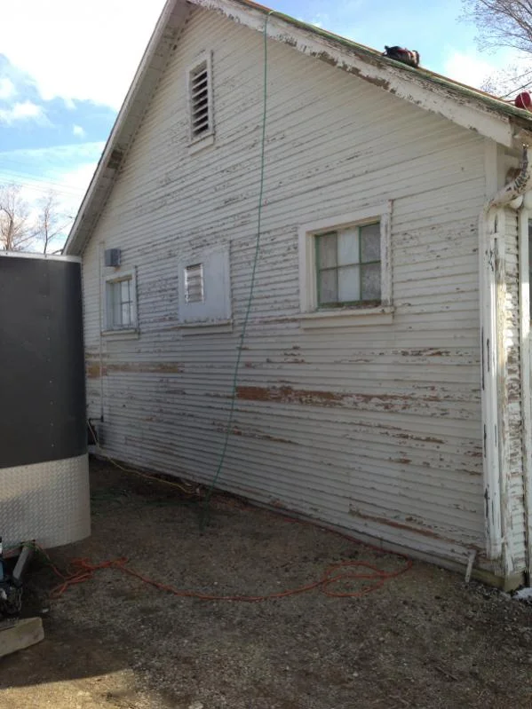

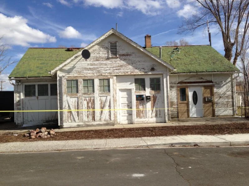

The windows are too small and more will be added. Heres a pic of the front
Don't use dark vinyl windows, you will get a lot more expansion out of them.
Unless you keep it wood, the character will be lost. And that means dollars when you sell.
If you are putting in larger windows, going with a wider trim means you may be able to just cut the existing siding to fit and not have to remove it all. I am doing that with my aluminum siding house. I cannot get matching panels and not ready to reside. The wider trim actually makes the house look more period so it was a win,win.
What material you use depends on your climate. While metal siding may be a bad idea in the humid southeast, a dry western state is a different story. A lot of metal panels are reflective enough that they cut down on solar heat gains.
I do this for a living, go with the Hardi, vinyl is crap, strip off the wood,peel & stick openings install new windows/doors, wrap house with moisture barrier, peel & stick all door and window perimeters, trim out all door & window with AZEK PVC trim, install 12" flashing around base of house, preSTAIN all hardi, I say stain,because it lasts longer than paint,2 coats. Install Hardi,as you cut it, knock off all "fuzz" on butt joints, when done use NP-1 caulk on joints and door/window seams.Touch up where needed..you'll never have to revisit your exterior again. oh, and use correct nails, don't skimp,siding install is only as good as how its fastened.

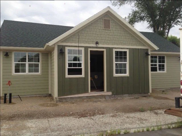

Nicely done!
What window brand / material type did you choose? I like the single hung look.
