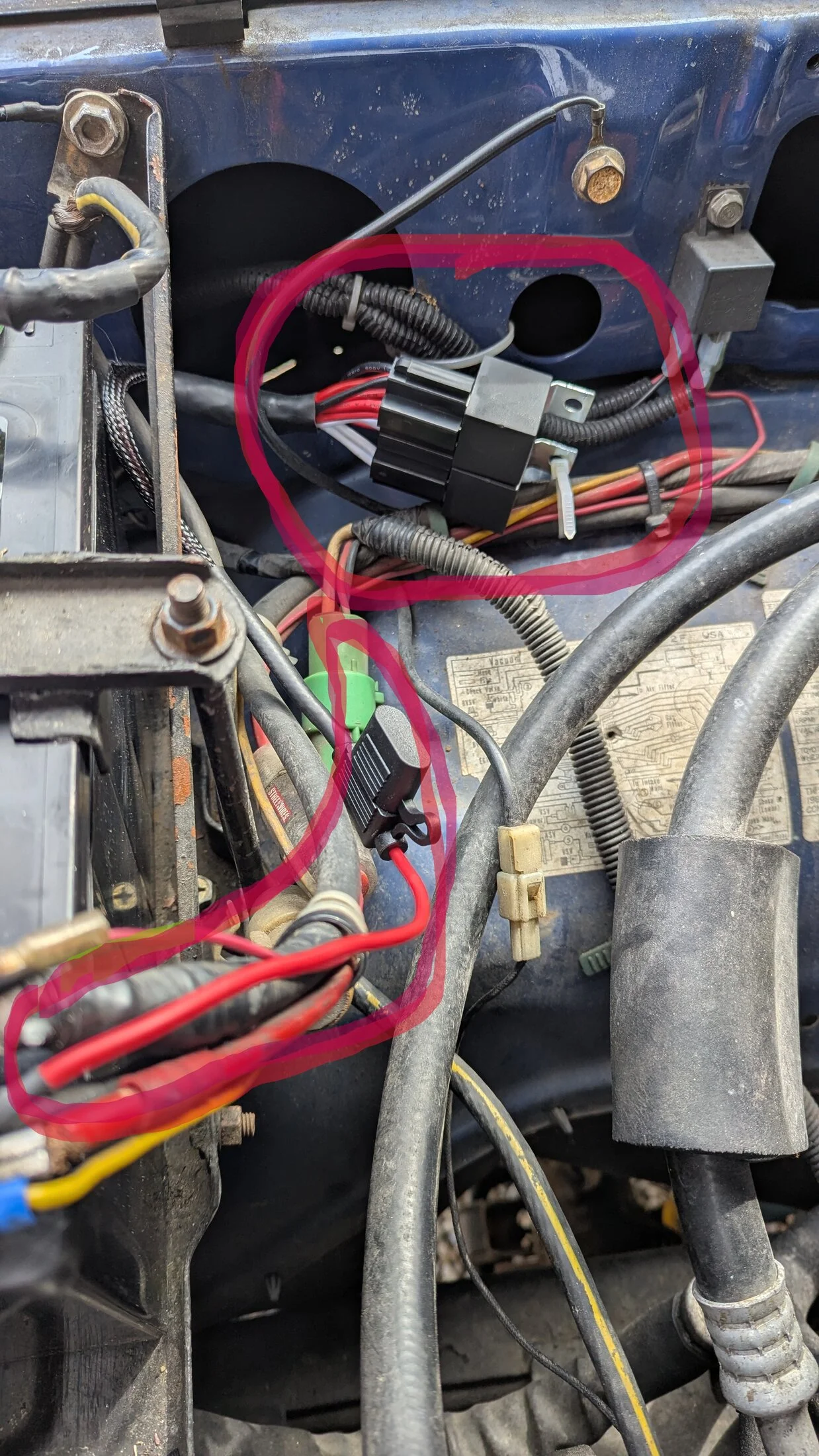

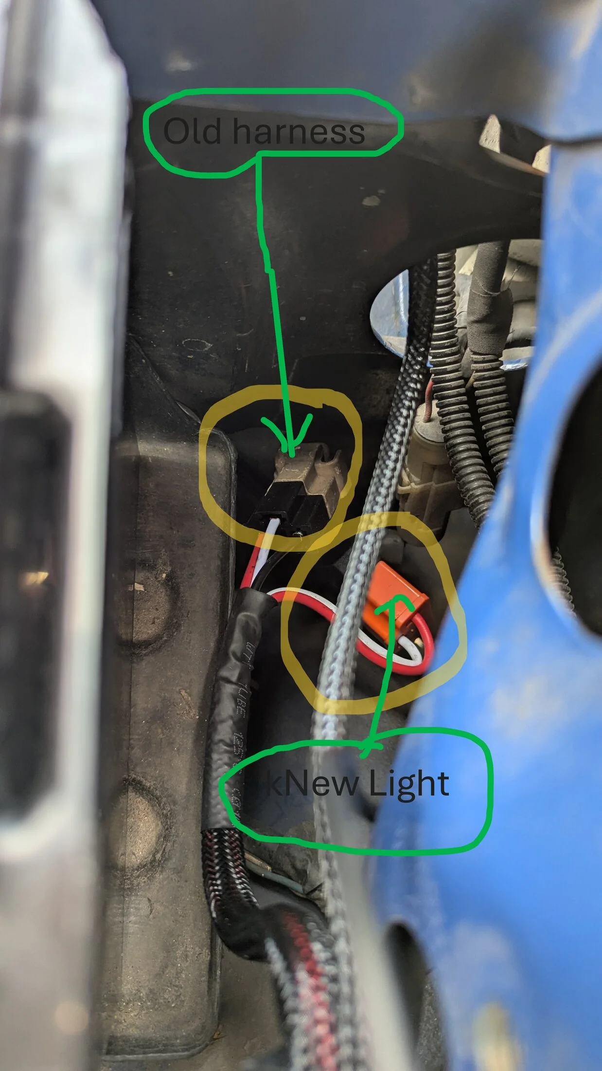

Not sure how well these pictures help but I just did the install. Very easy. The harness comes with two orange female plugs for each new light and one black one to hook into the old harness (also a 3 prong). There are a few ground wires as well. I could probably make my install a little more Pro, maybe someday I will hard mount the relays instead of just using a zip tie but......and I mounted the wire running across to the other light tucked inside the metal right behind the hood latch. I did NOT get the resistor since I use led's in my instrument panel, no need. The led's are great and easy to do, I bought different color leds instead of just relying on the "lens" color of the instrument panel, in some cases I also used a black Sharpie to cover the top diode in the led light since some of them are pretty bright (blinkers especially).
So wire the RED direct to the battery, Orange plugs to the new Holley's, Black into the old harness, in my case, from the passenger side, hook up the grounds wherever you can. Done. You could mount the relays in a different place but would have to extend the red power wire, in any case would have to be fairly close to the battery as the distance between the two new light plugs is not overly long.

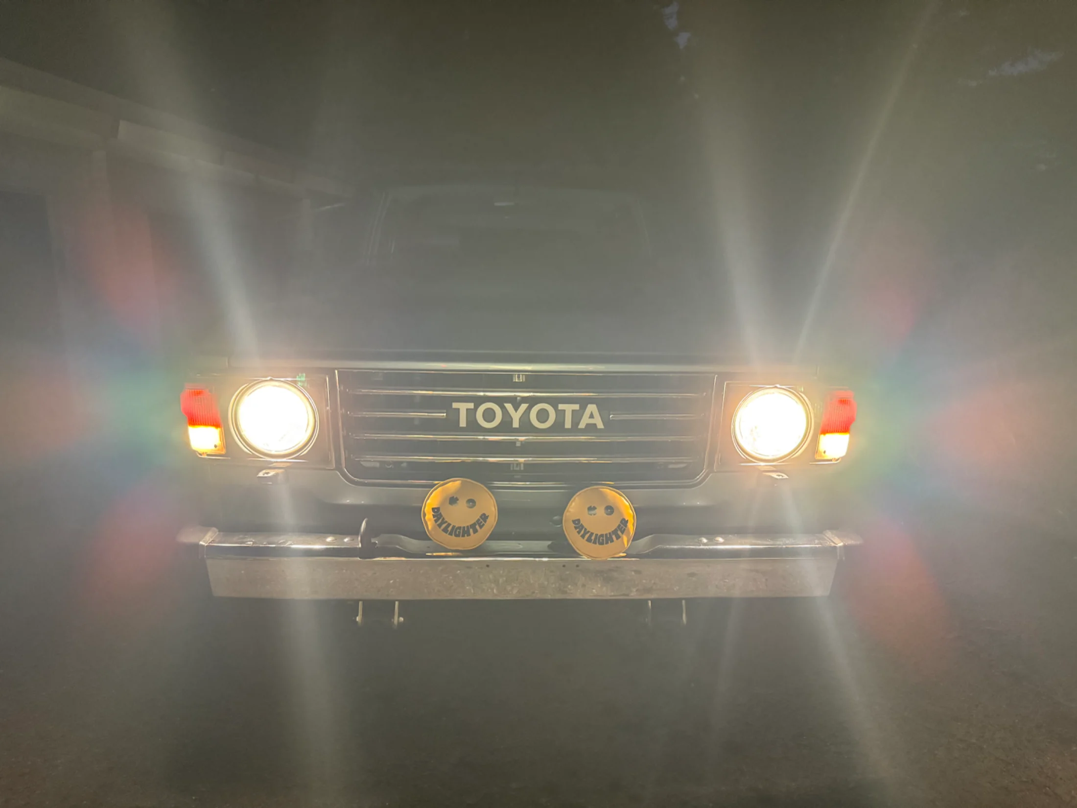

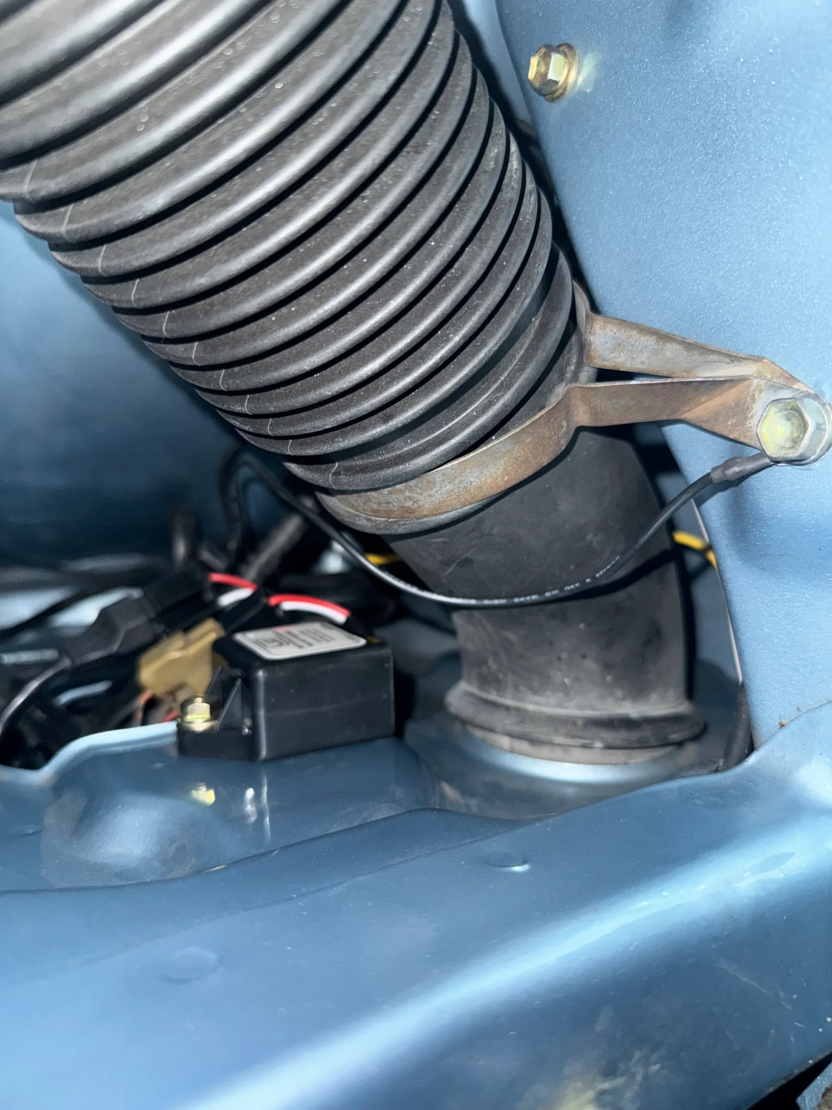

Hi, I posted in the "what did you do this weekend" thread that I upgraded my '84 FJ60 headlights to Holley Retrobrights. Several folks wanted a report about their performance. Instead of gumming up that thread I thought I would report here.
I bought and installed 2 Holley RetroBright headlamps and 2 LumaWerx H4/9003 Switching Ground Polarity Modules. They were very easy to install. I mounted the drivers side LumaWerx under the battery tray and grounded it to a bolt near by. For the passenger side I mounted the LumaWerx just above the hole that opens the head light opening to the engine bay (sorry for the bad terminology... But see picture) and grounded it to a bracket close by. Everything works including the "bright" indicator in the dashboard.
I chose the Holley RetroBrights "classic bright" at 3000 (K) because I enjoy the warm vibes. They are definitely brighter than my old lights but not as bright as modern cars. Tonight, a fancy BMW SUV passed me and it was definitely brighter. I am hesitant to say they are game changers but they are a definite improvement that I would recommend. The light beam photos are in a wooded pitch black area. I don't think the pictures do the lighting justice. I think in real life they are brighter, especially the brights, than photographed. Also, I think I need to raise the beams a bit which will improve the lighting even more.
