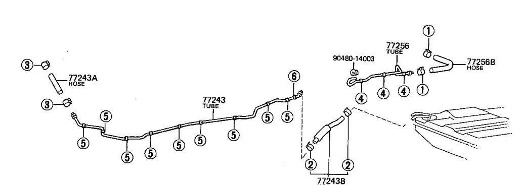

There is a fuel tube that runs the width of the vehicle above the rear shock support tube. Both my HJ60 and FJ60 had one, but the one in my HJ60 was rusted beyond recognition. I am using the FJ60 version in my HJ swapped truck, but can anyone say for certain how this tube connected to the tank or vapour separator? I can't find any diagrams that detail this out, and I don't have any surplus connection points on either the tank or separator. Here is the image from Partsouq for the HJ60 tube in question.
Anyone know?

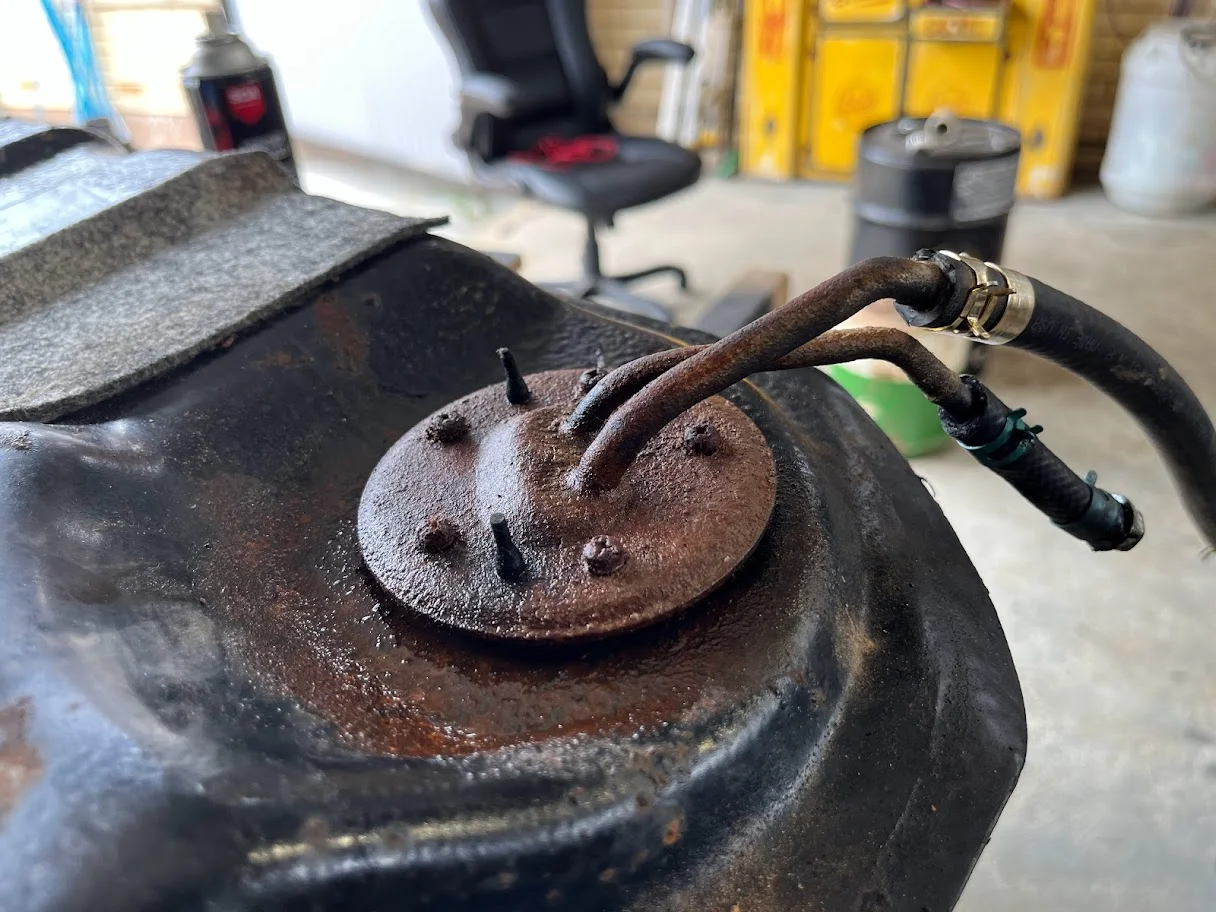

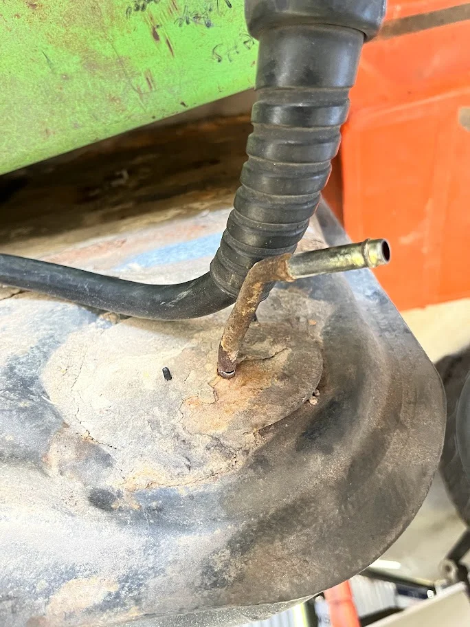

HJ60 tank.. one tube out for the pickup.. (ignore the welding gun in the pic)..
FJ60 two tubes out, one pickup, one return..
But the return line of the FJ60 doesn't connect to this tube as far as I can tell. What does this long, squiggly tube connect to? It seems to be part of the fuel vapour separator system, but not sure how it connects.
Hi Georgebj60,
the breather tube you are talking about is connected to the top of that plastic separator which sits in the RH rear behind the panel. It is venting that one.
It is connected via a non return valve (shown here, my HJ had it) and than goes through a connector before ist actually linked to the pipe you mentioned.
If mine would be rusted - I would just use a hose running to the same location.
Hope that helps.
Cheers

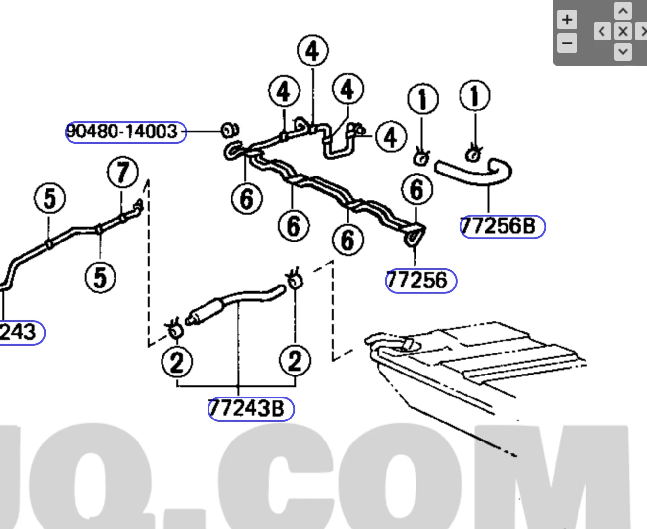

Here are the complete pictures.
77256 in the second picture is a bit shorter than your version but the same pipe . To prevent blocking it ends through a grommet inside the chassis.

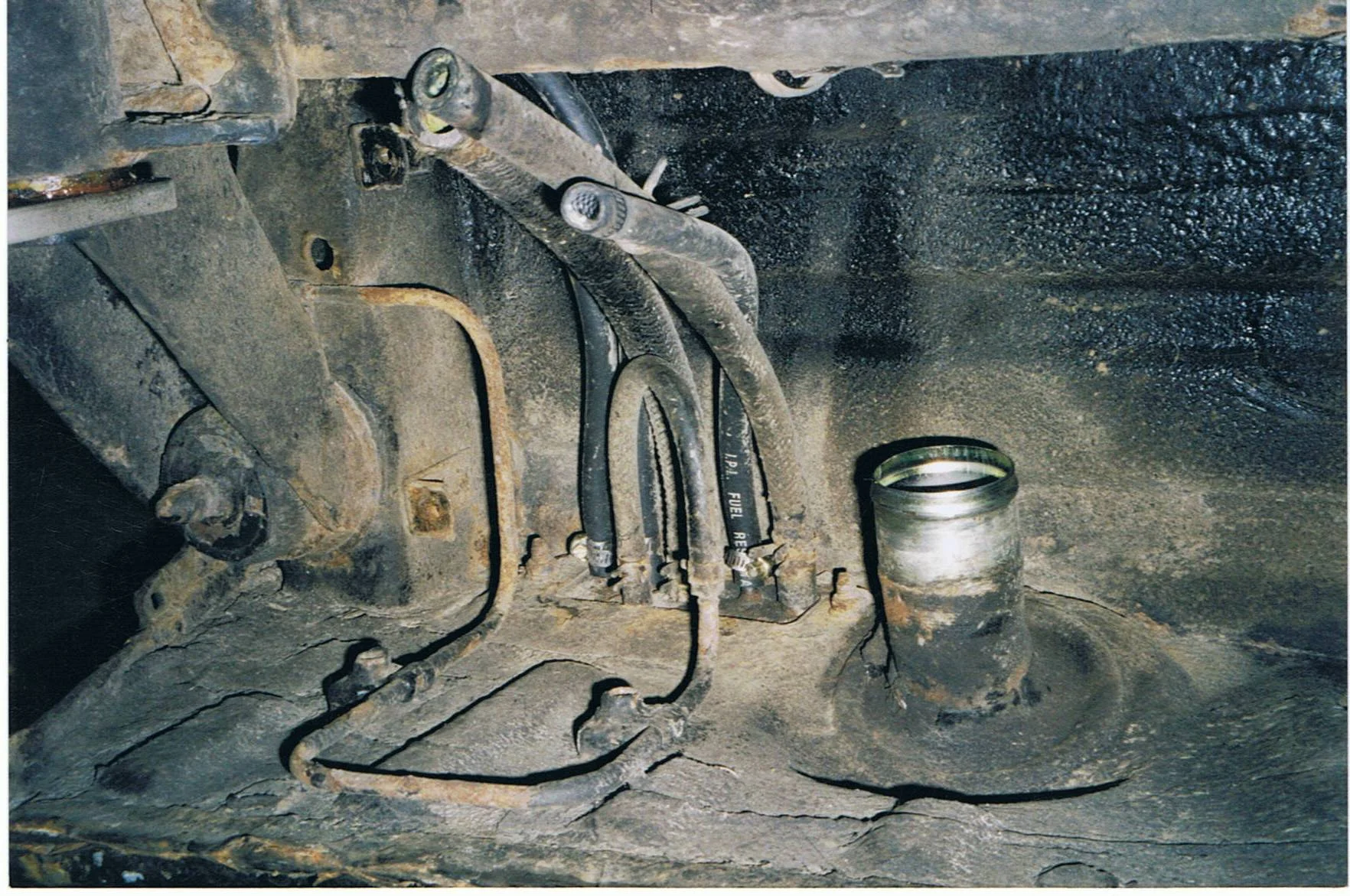

This is how it should be connected.
Mine has rusted out 20 years ago so i just capped the connection pipe while mounting a bigger tank No issues att all.
The other side of the piping is routed through a grommet in to the body structure strenghtening frame.
