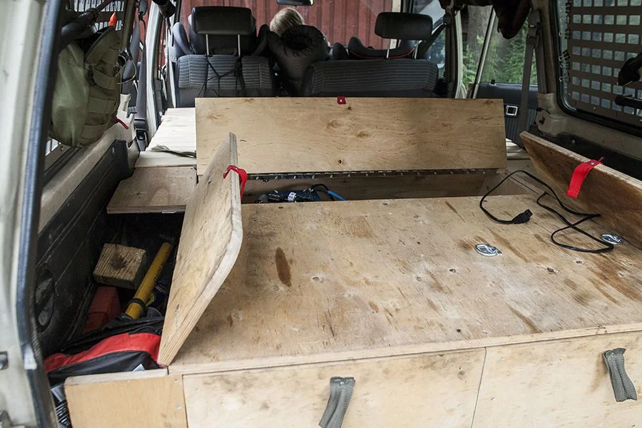

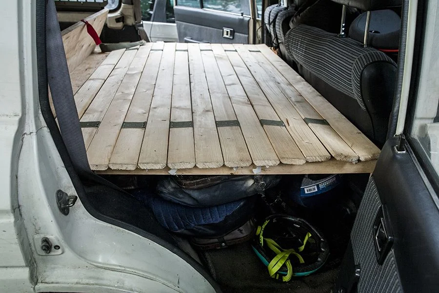

So i built rear drawer and bed system on super budget.
Didn't cover plywood with cloth on purpose because of need to transport dirty stuff like chainsaw etc and i knew i will probably build something new in future.
Went on 1-2day trip many time with family and system seemed to work. But when we went to week trip it wasn't comfy at all.
