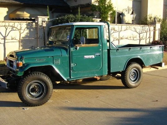

Finally found a truck I like. Are the H's welcome in the 'F' forum? Thanks everyone for help and input along the way.

Most trucks came from the factory that way. Unlockable hubs were add-ons (WARNs, etc), until Toyota started putting them on in the later 70s. The ability to release the front hub when you don't need the front drive results in reduced component wear (front driveshaft, differential, and hub mechanism, birf). And maybe a little less resistance to overcome and slightly better milage.
This is how the front hub assembly came from the factory until 9/75 (I think unlockables were optional after that):
you all know much more about it than i do. Is what you're describing still an okay system to have on my truck? I'd hate to feel compelled to change it so early in the stages of ownership...unless a manual locking hub an easy and highly recommended conversion to do...
Switching to manual hubs isn't difficult. I wouldn't worry about it personally. Drive it and see how you like it first etc.
I'd agree. I would think that the biggest issue would be wear on the front U joints, which would impact you after what, 150/200K depending? Just means you'd be servicing them sooner than you would otherwise.
