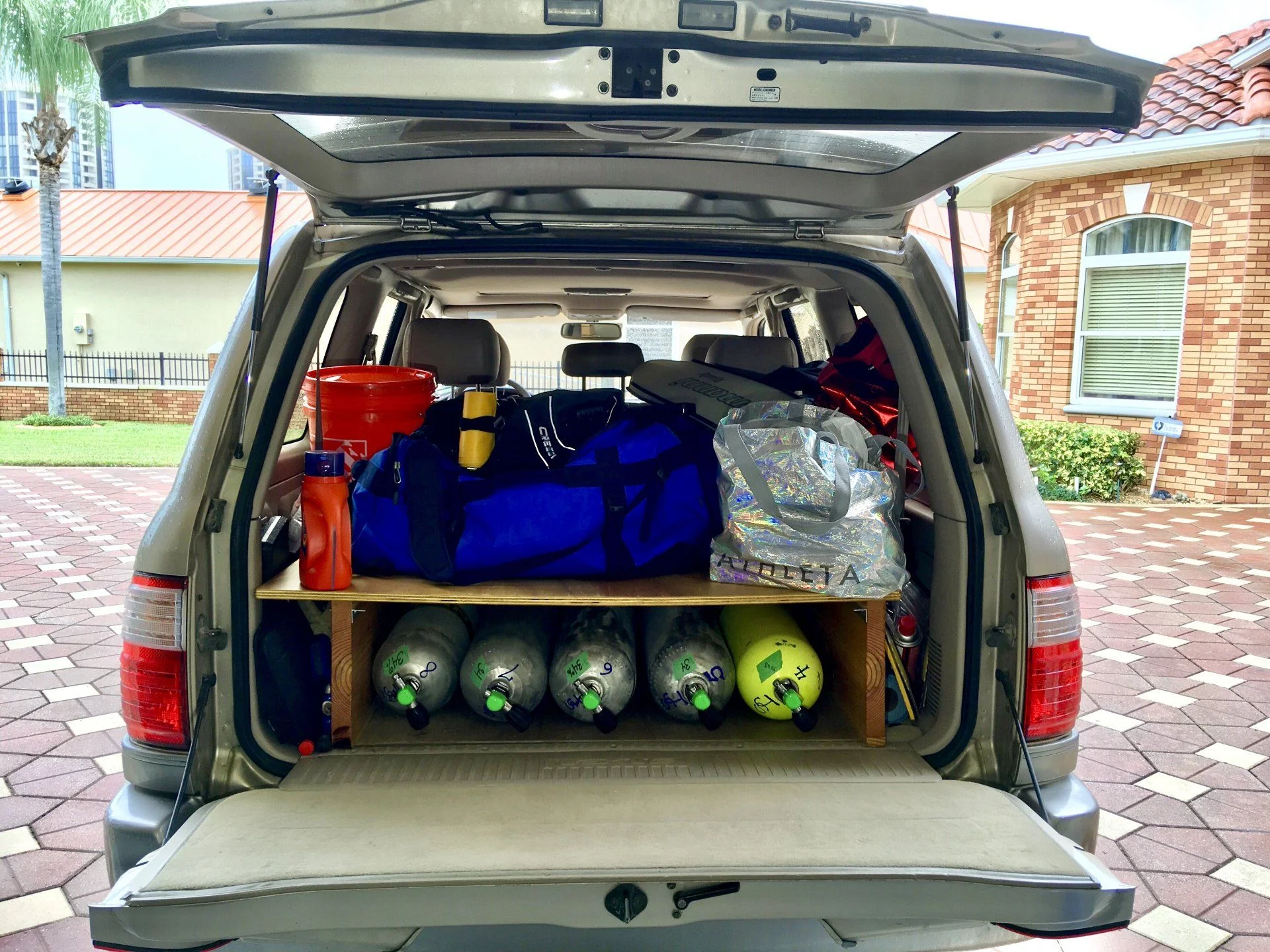

I’ve used my 3000psi AL80 tanks to fill up tires using my regular scuba first stage regulator...but only when I already had my them with me in my trunk. Otherwise I have a Viair 88p compressor that takes up way less space!
